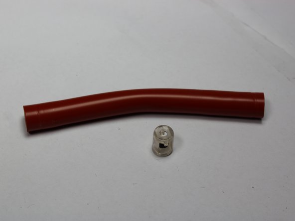

  10. Mr. Coffee BVMC-SJX33GT Valve Replacement, Valve: crwdns2935265:010crwdnd2935265:01crwdnd2935265:02crwdne2935265:0 Mr. Coffee BVMC-SJX33GT Valve Replacement, Valve: crwdns2935265:010crwdnd2935265:02crwdnd2935265:02crwdne2935265:0
    • After pulling the second tube out, locate the bulging part of the hose that indicates the valve's placement.
  11. Mr. Coffee BVMC-SJX33GT Valve Replacement: crwdns2935265:011crwdnd2935265:01crwdnd2935265:03crwdne2935265:0 Mr. Coffee BVMC-SJX33GT Valve Replacement: crwdns2935265:011crwdnd2935265:02crwdnd2935265:03crwdne2935265:0 Mr. Coffee BVMC-SJX33GT Valve Replacement: crwdns2935265:011crwdnd2935265:03crwdnd2935265:03crwdne2935265:0
    • Grip the tube and push the valve out the end of the hose.
    • Remember the direction of the valve when you pull it out because this valve is one way. If you insert it or reinsert it the wrong way, water will not flow through the coffee maker.

Thank you. Very well done. Do you know if I can buy a replacement valve?
Scott - crwdns2934203:0crwdne2934203:0
Unfortunately no. Because a lot of things are built with planned obsolescence in mind, it's very difficult to find parts. I would check thrift stores for same brand cheap coffee makers that might have similar equipment.
Mackenzie Aiken -
I have a similar model and the valve sticks at odd times...it brews half the pot and steams the rest of the water. I have cleaned, drilled the hole slightly larger that the ball seals in...with no solution! Will it it thermally pump water without the ball in the valve? Thanks!
elronhubbard - crwdns2934203:0crwdne2934203:0
Well firstly make sure the valve is pointing the right direction in the rubber tubing. As for your question about pumping water, that I can't answer. Try soaking the valve in alcohol then warm soapy water, there may be residue from the grinds on the ball causing it to stick.
Your best course of action might be to go to a thrift store and look for a similar model by Mr. Coffee and simply replace the valve. Drilling the hole initially might have thwarted additional attempts to make this valve work.
