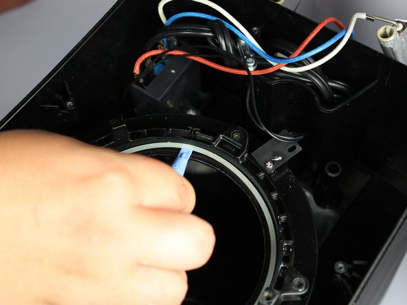

  14. Mr. Coffee BVMC-SJX33GT O-Rings Replacement: crwdns2935265:014crwdnd2935265:01crwdnd2935265:03crwdne2935265:0 Mr. Coffee BVMC-SJX33GT O-Rings Replacement: crwdns2935265:014crwdnd2935265:02crwdnd2935265:03crwdne2935265:0 Mr. Coffee BVMC-SJX33GT O-Rings Replacement: crwdns2935265:014crwdnd2935265:03crwdnd2935265:03crwdne2935265:0
    • Using a plastic opening tool, pry the first o-ring out of the plastic ring.
    • If you happen to mix up the o-rings, note that this o-ring is thicker than the second.

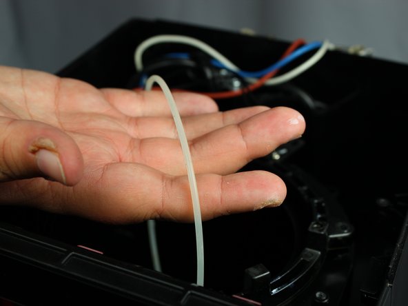

  16. Mr. Coffee BVMC-SJX33GT O-Rings Replacement: crwdns2935265:016crwdnd2935265:01crwdnd2935265:02crwdne2935265:0 Mr. Coffee BVMC-SJX33GT O-Rings Replacement: crwdns2935265:016crwdnd2935265:02crwdnd2935265:02crwdne2935265:0
    • Using your fingers, pry the other o-ring free from the plastic ring.
    • If you happen to mix up the o-rings, note that this o-ring is thinner than the first.
