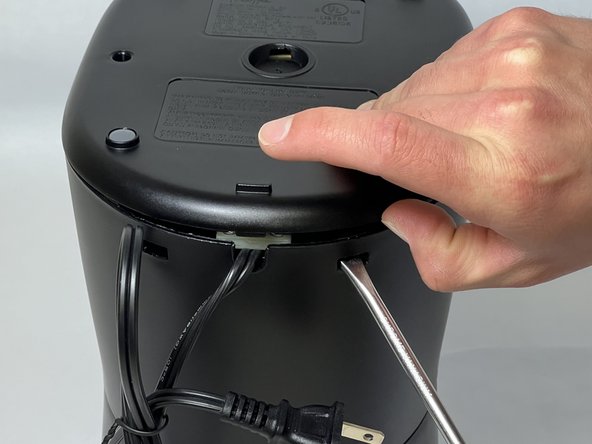

  2. Mr. Coffee 5-Cup Mini Brew Thermal Fuse Replacement: crwdns2935265:02crwdnd2935265:01crwdnd2935265:02crwdne2935265:0 Mr. Coffee 5-Cup Mini Brew Thermal Fuse Replacement: crwdns2935265:02crwdnd2935265:02crwdnd2935265:02crwdne2935265:0
    • Use the Y1 Tri-point screwdriver to remove the three 1.5 cm screws from the baseplate.

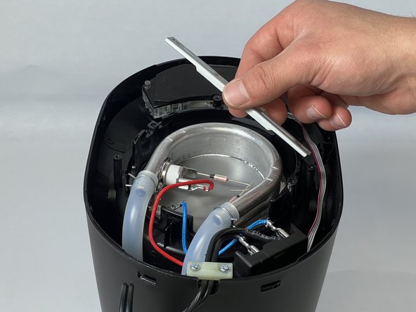

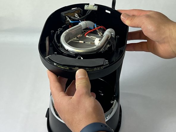

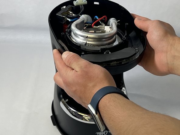

  3. Mr. Coffee 5-Cup Mini Brew Thermal Fuse Replacement: crwdns2935265:03crwdnd2935265:01crwdnd2935265:03crwdne2935265:0 Mr. Coffee 5-Cup Mini Brew Thermal Fuse Replacement: crwdns2935265:03crwdnd2935265:02crwdnd2935265:03crwdne2935265:0 Mr. Coffee 5-Cup Mini Brew Thermal Fuse Replacement: crwdns2935265:03crwdnd2935265:03crwdnd2935265:03crwdne2935265:0
    • Use a flathead screwdriver to unclip the two clips from the back of the baseplate.
    • Unsnap the front clips and remove the baseplate.

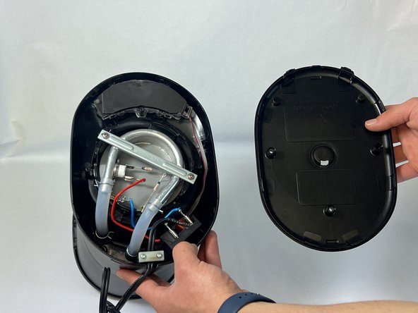

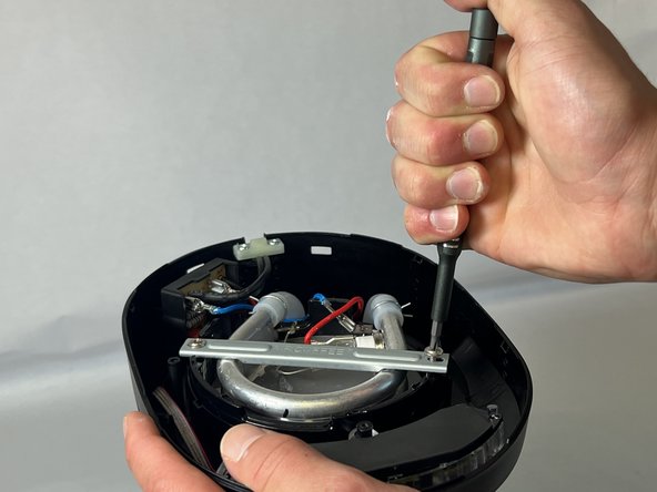

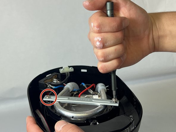

  4. Mr. Coffee 5-Cup Mini Brew Thermal Fuse Replacement: crwdns2935265:04crwdnd2935265:01crwdnd2935265:03crwdne2935265:0 Mr. Coffee 5-Cup Mini Brew Thermal Fuse Replacement: crwdns2935265:04crwdnd2935265:02crwdnd2935265:03crwdne2935265:0 Mr. Coffee 5-Cup Mini Brew Thermal Fuse Replacement: crwdns2935265:04crwdnd2935265:03crwdnd2935265:03crwdne2935265:0
    • Use a Phillips screwdriver to remove the two 1.5 cm screws on the metal bracket.
  5. Mr. Coffee 5-Cup Mini Brew Thermal Fuse Replacement: crwdns2935265:05crwdnd2935265:01crwdnd2935265:03crwdne2935265:0 Mr. Coffee 5-Cup Mini Brew Thermal Fuse Replacement: crwdns2935265:05crwdnd2935265:02crwdnd2935265:03crwdne2935265:0 Mr. Coffee 5-Cup Mini Brew Thermal Fuse Replacement: crwdns2935265:05crwdnd2935265:03crwdnd2935265:03crwdne2935265:0
    • Rotate the Mr. Coffee machine around so the front is facing you.

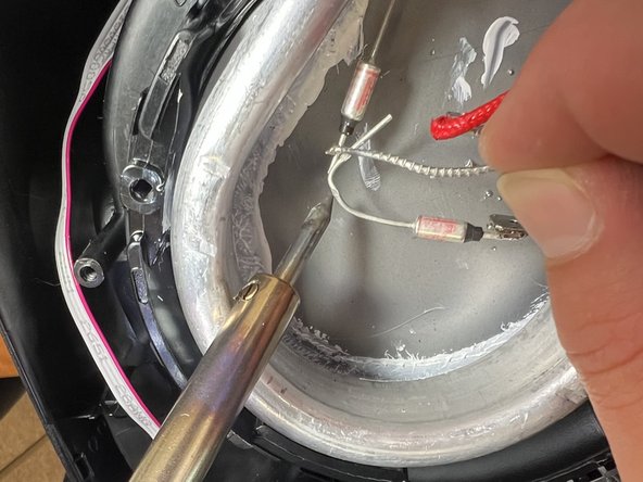

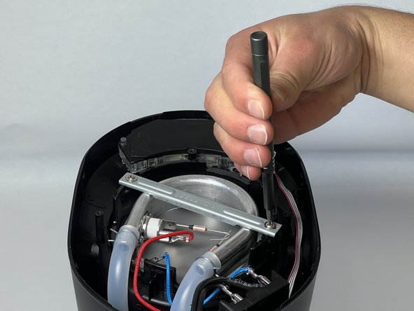

  6. Mr. Coffee 5-Cup Mini Brew Thermal Fuse Replacement: crwdns2935265:06crwdnd2935265:01crwdnd2935265:01crwdne2935265:0

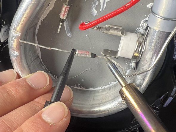

    • Locate the two thermal fuses.
    • The thermal fuses are attached to two different mounts and to each other.
  7. Mr. Coffee 5-Cup Mini Brew Thermal Fuse Replacement: crwdns2935265:07crwdnd2935265:01crwdnd2935265:03crwdne2935265:0 Mr. Coffee 5-Cup Mini Brew Thermal Fuse Replacement: crwdns2935265:07crwdnd2935265:02crwdnd2935265:03crwdne2935265:0 Mr. Coffee 5-Cup Mini Brew Thermal Fuse Replacement: crwdns2935265:07crwdnd2935265:03crwdnd2935265:03crwdne2935265:0
    • Clip each fuse where it connects with its mount with wire cutters.
    • Discard the fuses.
  8. Mr. Coffee 5-Cup Mini Brew Thermal Fuse Replacement: crwdns2935265:08crwdnd2935265:01crwdnd2935265:03crwdne2935265:0 Mr. Coffee 5-Cup Mini Brew Thermal Fuse Replacement: crwdns2935265:08crwdnd2935265:02crwdnd2935265:03crwdne2935265:0 Mr. Coffee 5-Cup Mini Brew Thermal Fuse Replacement: crwdns2935265:08crwdnd2935265:03crwdnd2935265:03crwdne2935265:0
    • Do not touch the hot soldering iron. Use in a well ventilated area.
    • Hold the tail of the fuse with tweezers at the contact point from the previous fuse.
    • Avoid contact with soldering iron and other internal components.
    • Melt the solder material with the soldering iron at the point of contact until it melts and beads onto the tail of the fuse.
    • Hold the head of the new fuse with the tweezers at the contact point from the removed fuse.
    • Melt the solder material with the soldering iron at the point of contact until it melts and beads onto the head of the fuse.
    • While touching the wires of the fuses together, melt the soldering material with the soldering iron until it melts and beads onto the two wires.
  9. Mr. Coffee 5-Cup Mini Brew Thermal Fuse Replacement: crwdns2935265:09crwdnd2935265:01crwdnd2935265:03crwdne2935265:0 Mr. Coffee 5-Cup Mini Brew Thermal Fuse Replacement: crwdns2935265:09crwdnd2935265:02crwdnd2935265:03crwdne2935265:0 Mr. Coffee 5-Cup Mini Brew Thermal Fuse Replacement: crwdns2935265:09crwdnd2935265:03crwdnd2935265:03crwdne2935265:0
    • Place the support beam back into the original place.
    • Use a Phillips #1 screwdriver to fasten the 1.5 cm screws into place on the metal bracket.
    • The screws can be distinguished by looking at the head type. The two Phillips screws are for the metal support beam on the inside. The three tri-point head type screws are for securing the baseplate on the outside.
