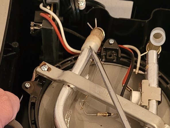

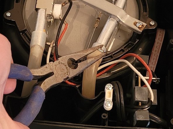

  4. Mr. Coffee 12-Cup Coffee Maker BVMC-EHXX33 Hose Replacement: crwdns2935265:04crwdnd2935265:01crwdnd2935265:02crwdne2935265:0 Mr. Coffee 12-Cup Coffee Maker BVMC-EHXX33 Hose Replacement: crwdns2935265:04crwdnd2935265:02crwdnd2935265:02crwdne2935265:0
    • Pinch the metal ties with a pair of needle-nose pliers.
    • Slide the metal tie off the metal tube base.

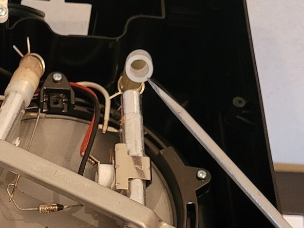

  5. Mr. Coffee 12-Cup Coffee Maker BVMC-EHXX33 Hose Replacement: crwdns2935265:05crwdnd2935265:01crwdnd2935265:03crwdne2935265:0 Mr. Coffee 12-Cup Coffee Maker BVMC-EHXX33 Hose Replacement: crwdns2935265:05crwdnd2935265:02crwdnd2935265:03crwdne2935265:0 Mr. Coffee 12-Cup Coffee Maker BVMC-EHXX33 Hose Replacement: crwdns2935265:05crwdnd2935265:03crwdnd2935265:03crwdne2935265:0
    • Use a spudger to push against the plastic tubing and slide it off the metal tube base.
