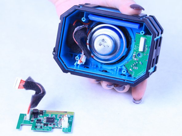

    • Remove four Hex 10 mm screws from the outer speaker cover displaying the speaker's serial number indicated by the red circle.
    • Carefully insert the spudger tool into one of the holes in the cover to pry open the outer cover of the speaker.
  2. Mpow MPBH063 Motherboard Replacement: crwdns2935265:02crwdnd2935265:01crwdnd2935265:01crwdne2935265:0
    • Remove four JIS J00 12mm screws.
    • Remove the inner speaker cover with the precision tweezers and a spudger if needed.
  3. Mpow MPBH063 Motherboard Replacement: crwdns2935265:03crwdnd2935265:01crwdnd2935265:01crwdne2935265:0
    • Carefully detach the battery from the adhesive securing the battery to the inner wall of the speaker.
    • Use the iFixit Adhesive Remover as directed to remove the battery from the inner wall of the speaker.
    • Detach the battery from the inner wall without detaching the wires connecting the battery to the motherboard.
  4. Mpow MPBH063 Motherboard Replacement: crwdns2935265:04crwdnd2935265:01crwdnd2935265:01crwdne2935265:0
    • Hold down the small lever on the white, plastic plug attached to the battery wires, and detach the wires from the white, plastic plug outlet on the motherboard.
  5. Mpow MPBH063 Motherboard Replacement, Motherboard: crwdns2935265:05crwdnd2935265:01crwdnd2935265:01crwdne2935265:0
    • Unplug all wires that are connected to the motherboard.
  6. Mpow MPBH063 Motherboard Replacement: crwdns2935265:06crwdnd2935265:01crwdnd2935265:02crwdne2935265:0 Mpow MPBH063 Motherboard Replacement: crwdns2935265:06crwdnd2935265:02crwdnd2935265:02crwdne2935265:0
    • Detach the motherboard from the speaker using the tech knife and the adhesive remover to remove the adhesive securing the motherboard.
    • Use iFixit Adhesive Remover as directed.
    • Use the precision tweezers with the blunt head to carefully grip and pull out the motherboard.
    • Proceed with caution when using the tech knife and removing the motherboard as you do not want to cause injury to yourself or the device.
