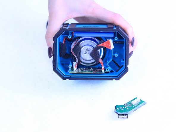

Mpow MPBH063 Daughterboard Replacement
  1. Mpow MPBH063 Daughterboard Replacement, Daughterboard: crwdns2935265:01crwdnd2935265:01crwdnd2935265:01crwdne2935265:0
    • Remove four Hex 10 mm screws from the outer speaker cover displaying the speaker's serial number indicated by the red circle.
    • Carefully insert the spudger tool into one of the holes in the cover to pry open the outer cover of the speaker.
  2. Mpow MPBH063 Daughterboard Replacement: crwdns2935265:02crwdnd2935265:01crwdnd2935265:01crwdne2935265:0
    • Remove four JIS J00 12mm screws.
    • Remove the inner speaker cover with the precision tweezers and a spudger if needed.
  3. Mpow MPBH063 Daughterboard Replacement: crwdns2935265:03crwdnd2935265:01crwdnd2935265:01crwdne2935265:0
    • Unplug the wire connected to the daughterboard.
  4. Mpow MPBH063 Daughterboard Replacement: crwdns2935265:04crwdnd2935265:01crwdnd2935265:01crwdne2935265:0
    • Remove the silver 10 mm screw from the center of the daughterboard.
  5. Mpow MPBH063 Daughterboard Replacement: crwdns2935265:05crwdnd2935265:01crwdnd2935265:02crwdne2935265:0 Mpow MPBH063 Daughterboard Replacement: crwdns2935265:05crwdnd2935265:02crwdnd2935265:02crwdne2935265:0
    • Remove the daughterboard by carefully lifting the daughterboard out of the speaker with the metal spudger.
    • Use iFixit adhesive remover as directed
    • Before you remove the daughterboard, cut around the edges using the tech knife, and remove the adhesive securing the daughterboard to the speaker.
