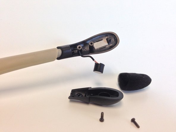

    • Remove star head screw from above base of the microphone with T6 Torx Screwdriver.
    • To prevent stripping, use an appropriate bit and ensure screwdriver is oriented perpendicular to the face of the screw.
  2. Motorola syn1654A Microphone Replacement: crwdns2935265:02crwdnd2935265:01crwdnd2935265:01crwdne2935265:0
    • To expose the next screw, peel foam cover from the base toward the end of microphone.
    • Remove screw with screwdriver and place in a safe location.
  3. Motorola syn1654A Microphone Replacement: crwdns2935265:03crwdnd2935265:01crwdnd2935265:03crwdne2935265:0 Motorola syn1654A Microphone Replacement: crwdns2935265:03crwdnd2935265:02crwdnd2935265:03crwdne2935265:0 Motorola syn1654A Microphone Replacement: crwdns2935265:03crwdnd2935265:03crwdnd2935265:03crwdne2935265:0
    • With Screws removed, remove the microphone from foam and plastic cover to be inspected.
    • If the microphone is corroded or wires are frayed, it must be replaced.

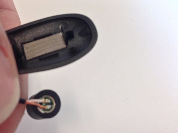

  4. Motorola syn1654A Microphone Replacement: crwdns2935265:04crwdnd2935265:01crwdnd2935265:01crwdne2935265:0
    • Clip both wires to remove defective microphone.
    • Be sure to clip as close to the base of the microphone as possible in order to have enough wire for the new microphone.
    • Align wires with corresponding pads on new microphone and solder in place.
    • For soldering, see the Ifixit soldering guide: How To Solder and Desolder Connections
