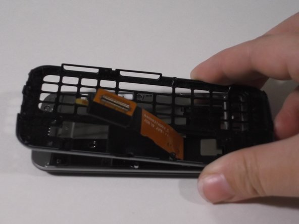

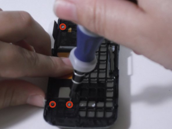

    2. Motorola i886 Screen Replacement: crwdns2935265:010crwdnd2935265:01crwdnd2935265:03crwdne2935265:0 Motorola i886 Screen Replacement: crwdns2935265:010crwdnd2935265:02crwdnd2935265:03crwdne2935265:0 Motorola i886 Screen Replacement: crwdns2935265:010crwdnd2935265:03crwdnd2935265:03crwdne2935265:0
      • Remove the loose volume, speaker, and camera buttons.
      • Remove four silver .2 centimeter screws above and below the gold and black strip with a T4 Torx screwdriver.
      • Separate the two parts of the phone by holding one side in each hand and pulling them apart. Set the part that held the slide-out keyboard aside.
