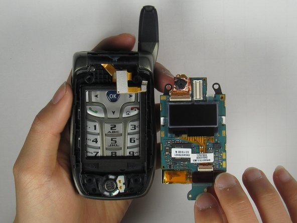

  9. Motorola i850 Speaker Replacement: crwdns2935265:09crwdnd2935265:01crwdnd2935265:01crwdne2935265:0
    • Gently detach the black microchip from the phone with a Tweezer.
  10. Motorola i850 Speaker Replacement: crwdns2935265:010crwdnd2935265:01crwdnd2935265:01crwdne2935265:0
    • Prop out the LCD board from the phone using your fingertips.
  11. Motorola i850 Speaker Replacement: crwdns2935265:011crwdnd2935265:01crwdnd2935265:02crwdne2935265:0 Motorola i850 Speaker Replacement: crwdns2935265:011crwdnd2935265:02crwdnd2935265:02crwdne2935265:0
    • Remove the LCD board from the phone by grabbing the bottom side of the LCD board.
  12. Motorola i850 Speaker Replacement, Speaker: crwdns2935265:012crwdnd2935265:01crwdnd2935265:01crwdne2935265:0
    • Use a flathead screwdriver to gently remove the speaker.
  13. Motorola i850 Speaker Replacement: crwdns2935265:013crwdnd2935265:01crwdnd2935265:01crwdne2935265:0
    • Insert the new speaker into the phone and it should look like the image at left.
