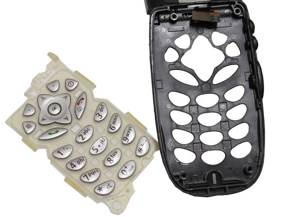

  5. Motorola i710 Keypad Cover Replacement, Keypad Sensor: crwdns2935265:05crwdnd2935265:01crwdnd2935265:02crwdne2935265:0 Motorola i710 Keypad Cover Replacement, Keypad Sensor: crwdns2935265:05crwdnd2935265:02crwdnd2935265:02crwdne2935265:0
    • Once the motherboard has been removed from the keypad, the keypad sensor can be detached from the phone at the hinge.
    • Gently pry off the cable connecting the keypad sensor. The keypad sensor should now be completely separated from the phone.
  6. Motorola i710 Keypad Cover Replacement, Keypad Cover: crwdns2935265:06crwdnd2935265:01crwdnd2935265:02crwdne2935265:0 Motorola i710 Keypad Cover Replacement, Keypad Cover: crwdns2935265:06crwdnd2935265:02crwdnd2935265:02crwdne2935265:0
    • Once the keypad has been removed, the keypad cover can be easily peeled back from the front phone cover molding.
    • Care must be taken when inserting a new keypad cover. The keypad cover will have to be lined up to the corresponding holes of the phone casing.
