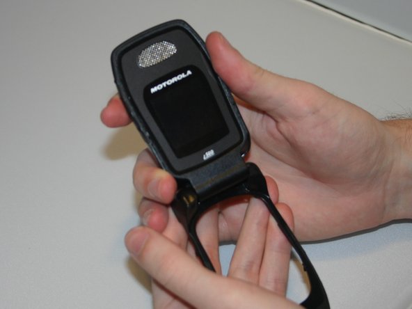

  10. Motorola i560 Screen Replacement, Screen: crwdns2935265:010crwdnd2935265:01crwdnd2935265:02crwdne2935265:0 Motorola i560 Screen Replacement, Screen: crwdns2935265:010crwdnd2935265:02crwdnd2935265:02crwdne2935265:0
    • By applying force, "pop" the screen out of the connecting hinge frame of the phone.

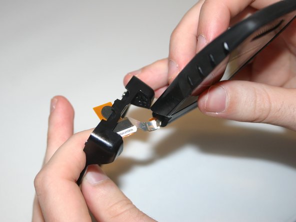

  11. Motorola i560 Screen Replacement: crwdns2935265:011crwdnd2935265:01crwdnd2935265:02crwdne2935265:0 Motorola i560 Screen Replacement: crwdns2935265:011crwdnd2935265:02crwdnd2935265:02crwdne2935265:0
    • Carefully slide the speaker ribbon cable through the slot in the front frame of the phone.
  12. Motorola i560 Screen Replacement: crwdns2935265:012crwdnd2935265:01crwdnd2935265:01crwdne2935265:0
    • After sliding the ribbon cable through the front frame of the phone, the separated screen and phone frame will appear as shown.
