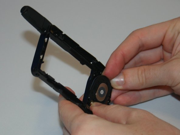

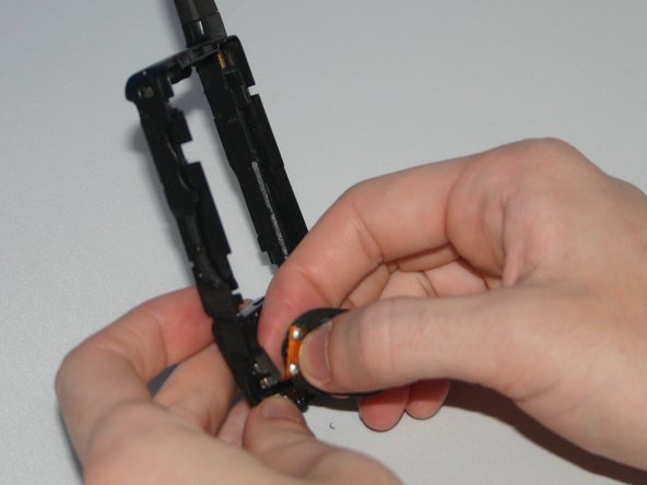

  9. Motorola i560 Microphone Replacement, Microphone: crwdns2935265:09crwdnd2935265:01crwdnd2935265:03crwdne2935265:0 Motorola i560 Microphone Replacement, Microphone: crwdns2935265:09crwdnd2935265:02crwdnd2935265:03crwdne2935265:0 Motorola i560 Microphone Replacement, Microphone: crwdns2935265:09crwdnd2935265:03crwdnd2935265:03crwdne2935265:0
    • Slightly bend the phone frame to expose microphone protrusion.
    • Gently remove microphone using your fingers.
  10. Motorola i560 Microphone Replacement: crwdns2935265:010crwdnd2935265:01crwdnd2935265:01crwdne2935265:0
    • Once the microphone has been removed, remove the connecting piece
