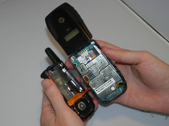

  5. Motorola i560 Metal Support Plate Replacement: crwdns2935265:05crwdnd2935265:01crwdnd2935265:02crwdne2935265:0 Motorola i560 Metal Support Plate Replacement: crwdns2935265:05crwdnd2935265:02crwdnd2935265:02crwdne2935265:0
    • Gently separate the front and back sides of the phone.
    • Be careful not to break or bend the ribbon cables.
  6. Motorola i560 Metal Support Plate Replacement: crwdns2935265:06crwdnd2935265:01crwdnd2935265:02crwdne2935265:0 Motorola i560 Metal Support Plate Replacement: crwdns2935265:06crwdnd2935265:02crwdnd2935265:02crwdne2935265:0
    • Detach the first ribbon cable by unplugging it from the logic board.

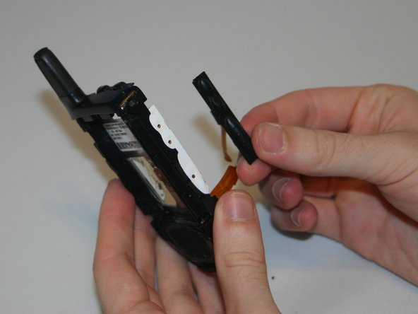

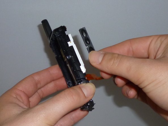

  7. Motorola i560 Metal Support Plate Replacement: crwdns2935265:07crwdnd2935265:01crwdnd2935265:03crwdne2935265:0 Motorola i560 Metal Support Plate Replacement: crwdns2935265:07crwdnd2935265:02crwdnd2935265:03crwdne2935265:0 Motorola i560 Metal Support Plate Replacement: crwdns2935265:07crwdnd2935265:03crwdnd2935265:03crwdne2935265:0
    • Gently remove the side button by pulling the buttons away from the phone.
  8. Motorola i560 Metal Support Plate Replacement, Metal Support Plate: crwdns2935265:08crwdnd2935265:01crwdnd2935265:03crwdne2935265:0 Motorola i560 Metal Support Plate Replacement, Metal Support Plate: crwdns2935265:08crwdnd2935265:02crwdnd2935265:03crwdne2935265:0 Motorola i560 Metal Support Plate Replacement, Metal Support Plate: crwdns2935265:08crwdnd2935265:03crwdnd2935265:03crwdne2935265:0
    • Grab the tab at the bottom of the metal plate, and pull to remove the plate from the phone.
