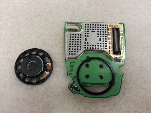

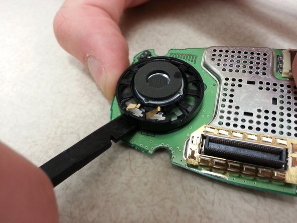

  12. Motorola i1000plus Speaker Replacement, Speaker: crwdns2935265:012crwdnd2935265:01crwdnd2935265:03crwdne2935265:0 Motorola i1000plus Speaker Replacement, Speaker: crwdns2935265:012crwdnd2935265:02crwdnd2935265:03crwdne2935265:0 Motorola i1000plus Speaker Replacement, Speaker: crwdns2935265:012crwdnd2935265:03crwdnd2935265:03crwdne2935265:0
    • Flip the keypad circuit board over to the other side to access the speaker.
    • Using the spudger, pry the speaker off of the circuit board.
    • The speaker is lightly glued to the circuit board. When prying the speaker off, there will be some resistance.
