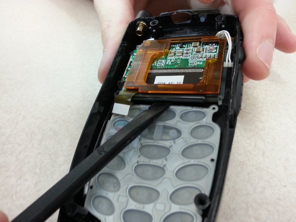

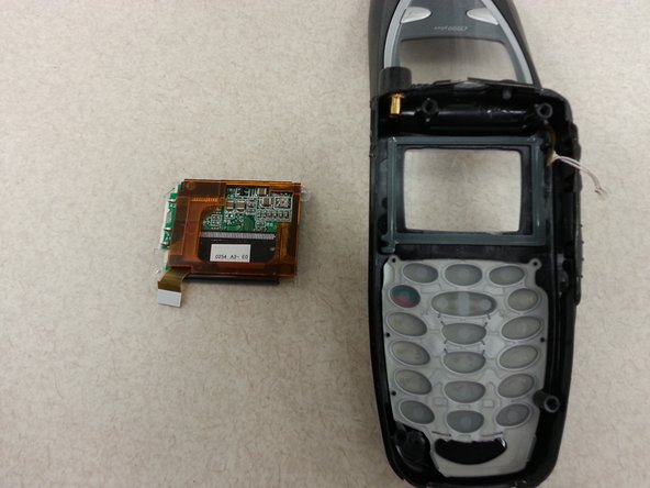

  11. Motorola i1000plus Screen Circuit Board Replacement, Screen Circuit Board: crwdns2935265:011crwdnd2935265:01crwdnd2935265:03crwdne2935265:0 Motorola i1000plus Screen Circuit Board Replacement, Screen Circuit Board: crwdns2935265:011crwdnd2935265:02crwdnd2935265:03crwdne2935265:0 Motorola i1000plus Screen Circuit Board Replacement, Screen Circuit Board: crwdns2935265:011crwdnd2935265:03crwdnd2935265:03crwdne2935265:0
    • Using a spudger, pry the screen circuit board out of the front phone case.
    • This circuit board is lightly glued in place so there will be some resistance when removing it.
    • Be careful not to touch the screen or the plastic in the front phone case as both can be easily scratched.
