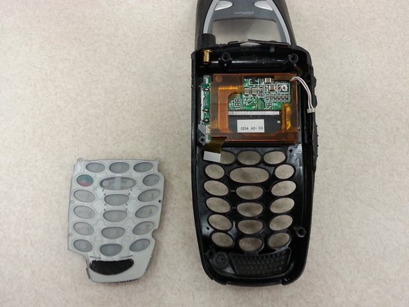

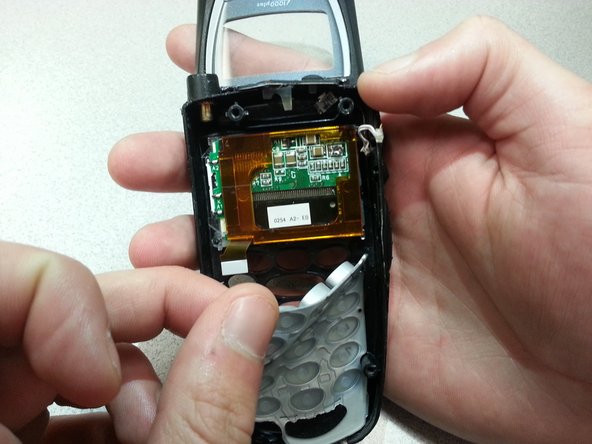

  11. Motorola i1000plus Keypad Replacement, Keypad: crwdns2935265:011crwdnd2935265:01crwdnd2935265:03crwdne2935265:0 Motorola i1000plus Keypad Replacement, Keypad: crwdns2935265:011crwdnd2935265:02crwdnd2935265:03crwdne2935265:0 Motorola i1000plus Keypad Replacement, Keypad: crwdns2935265:011crwdnd2935265:03crwdnd2935265:03crwdne2935265:0
    • Using your fingers, carefully lift the rubber keypad from the phone.
    • Note the pegs that stick through the rubber keypad. Lift the keypad carefully so that the pegs do not rip the rubber.
