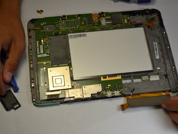

Motorola Xoom Wifi Display Assembly Replacement
    1. Motorola Xoom Wifi Display Assembly Replacement, Back Cover Disassembly: crwdns2935265:01crwdnd2935265:01crwdnd2935265:02crwdne2935265:0 Motorola Xoom Wifi Display Assembly Replacement, Back Cover Disassembly: crwdns2935265:01crwdnd2935265:02crwdnd2935265:02crwdne2935265:0
      • There are two 6.6 mm screws that hold ports into place as well as the back panel. Remove these with a T5 Torx screwdriver.
    2. Motorola Xoom Wifi Display Assembly Replacement: crwdns2935265:02crwdnd2935265:01crwdnd2935265:02crwdne2935265:0 Motorola Xoom Wifi Display Assembly Replacement: crwdns2935265:02crwdnd2935265:02crwdnd2935265:02crwdne2935265:0
      • Apply light pressure with hand and slide the back plate till it stops in this position.
      • There is a flex clip on both sides that need to be pushed down in order for the plate to slide off completely. Use a plastic opening tool to release the flex clips. They are located under the back cover near the sides.
      • As soon as the clips are released the back should slide off.
    3. Motorola Xoom Wifi Display Assembly Replacement: crwdns2935265:03crwdnd2935265:01crwdnd2935265:03crwdne2935265:0 Motorola Xoom Wifi Display Assembly Replacement: crwdns2935265:03crwdnd2935265:02crwdnd2935265:03crwdne2935265:0 Motorola Xoom Wifi Display Assembly Replacement: crwdns2935265:03crwdnd2935265:03crwdnd2935265:03crwdne2935265:0
      • Remove last two 4.2 mm screws from the remaining back piece with a T5 Torx screwdriver.
      • Once both screws are taken out, lift the rest of the backing out of the way.

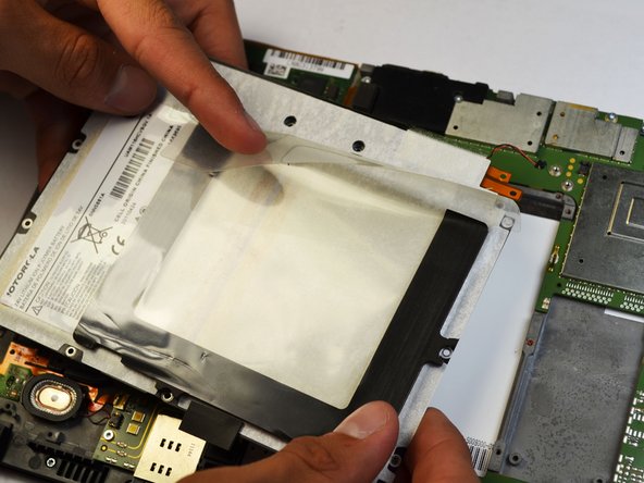

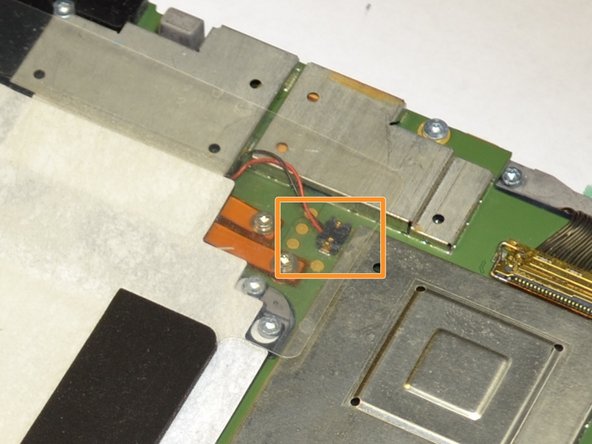

    1. Motorola Xoom Wifi Display Assembly Replacement, Battery: crwdns2935265:04crwdnd2935265:01crwdnd2935265:02crwdne2935265:0 Motorola Xoom Wifi Display Assembly Replacement, Battery: crwdns2935265:04crwdnd2935265:02crwdnd2935265:02crwdne2935265:0
      • Remove the two battery leads with a T-5 Torx screwdriver.
      • Grab the red and black wires with your fingers and gently lift to disconnect black wire connector from the motherboard.
    2. Motorola Xoom Wifi Display Assembly Replacement: crwdns2935265:05crwdnd2935265:01crwdnd2935265:02crwdne2935265:0 Motorola Xoom Wifi Display Assembly Replacement: crwdns2935265:05crwdnd2935265:02crwdnd2935265:02crwdne2935265:0
      • All that holds the battery in are twelve screws. Remove them with a T-6 Torx screwdriver.
      • The battery should lift out easily.

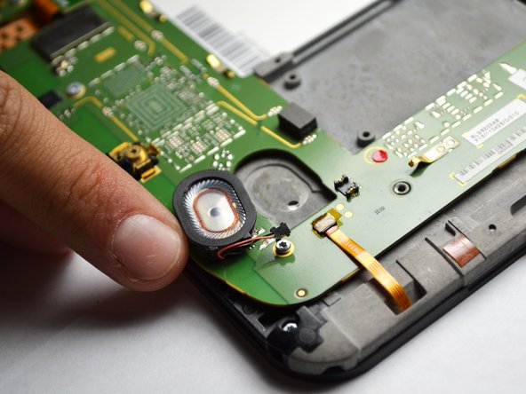

    1. Motorola Xoom Wifi Display Assembly Replacement, Speakers: crwdns2935265:06crwdnd2935265:01crwdnd2935265:02crwdne2935265:0 Motorola Xoom Wifi Display Assembly Replacement, Speakers: crwdns2935265:06crwdnd2935265:02crwdnd2935265:02crwdne2935265:0
      • Use a plastic opening tool to pop out the speaker. Make sure to carefully pull off the wire as well.
      • Replace speaker if necessary.

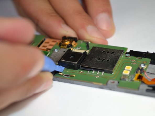

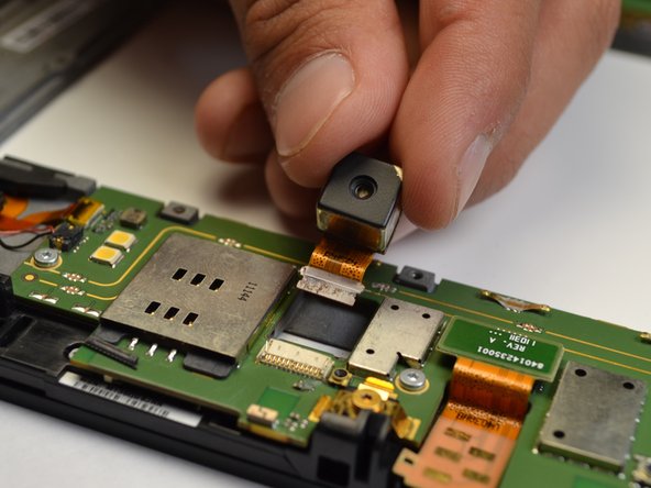

    1. Motorola Xoom Wifi Display Assembly Replacement, Back-Facing Camera: crwdns2935265:07crwdnd2935265:01crwdnd2935265:02crwdne2935265:0 Motorola Xoom Wifi Display Assembly Replacement, Back-Facing Camera: crwdns2935265:07crwdnd2935265:02crwdnd2935265:02crwdne2935265:0
      • Use a spudger or a fine tip to lift the black tab to a vertical position.
      • A spudger is needed to remove the plastic border around the camera.
    2. Motorola Xoom Wifi Display Assembly Replacement: crwdns2935265:08crwdnd2935265:01crwdnd2935265:02crwdne2935265:0 Motorola Xoom Wifi Display Assembly Replacement: crwdns2935265:08crwdnd2935265:02crwdnd2935265:02crwdne2935265:0
      • When lifting the camera out, be sure to pull the orange ribbon cable as well.

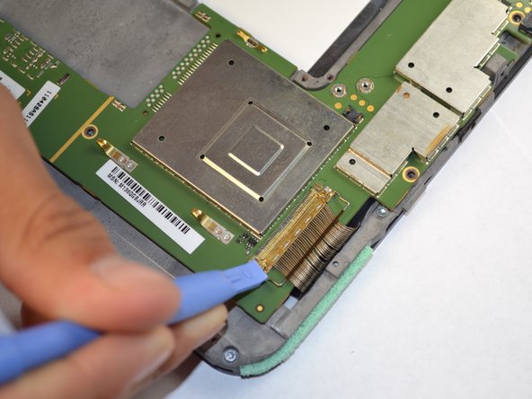

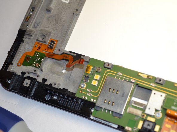

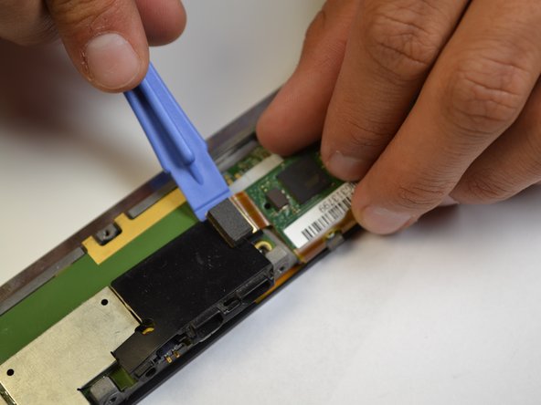

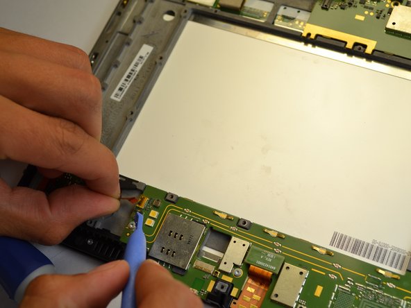

    1. Motorola Xoom Wifi Display Assembly Replacement, Motherboard: crwdns2935265:09crwdnd2935265:01crwdnd2935265:03crwdne2935265:0 Motorola Xoom Wifi Display Assembly Replacement, Motherboard: crwdns2935265:09crwdnd2935265:02crwdnd2935265:03crwdne2935265:0 Motorola Xoom Wifi Display Assembly Replacement, Motherboard: crwdns2935265:09crwdnd2935265:03crwdnd2935265:03crwdne2935265:0
      • Take a plastic opening tool and carefully pry off the touch screen controller connection.
      • Be careful with the black cover under the connection.
    2. Motorola Xoom Wifi Display Assembly Replacement: crwdns2935265:010crwdnd2935265:01crwdnd2935265:03crwdne2935265:0 Motorola Xoom Wifi Display Assembly Replacement: crwdns2935265:010crwdnd2935265:02crwdnd2935265:03crwdne2935265:0 Motorola Xoom Wifi Display Assembly Replacement: crwdns2935265:010crwdnd2935265:03crwdnd2935265:03crwdne2935265:0
      • There are two relay wires that must be disconnected.
      • Pull both relay wires out of their connection ports.
      • Make sure to flip up the small black tab before you pull out the wire.
    3. Motorola Xoom Wifi Display Assembly Replacement: crwdns2935265:011crwdnd2935265:01crwdnd2935265:02crwdne2935265:0 Motorola Xoom Wifi Display Assembly Replacement: crwdns2935265:011crwdnd2935265:02crwdnd2935265:02crwdne2935265:0
      • Using a plastic opener, lift the metal bar clasping the wire harness to the motherboard.

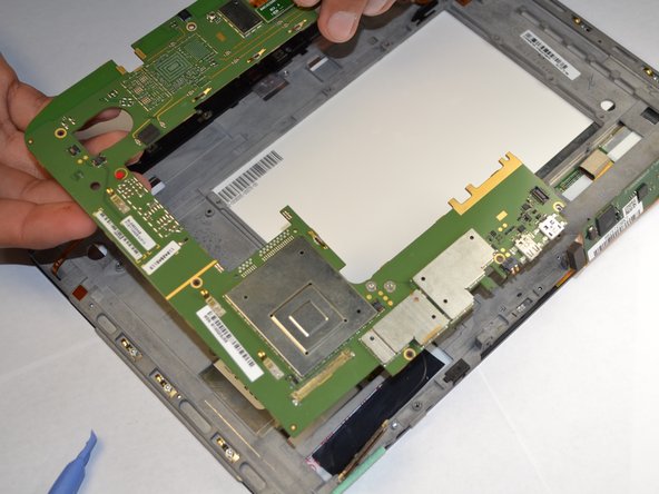

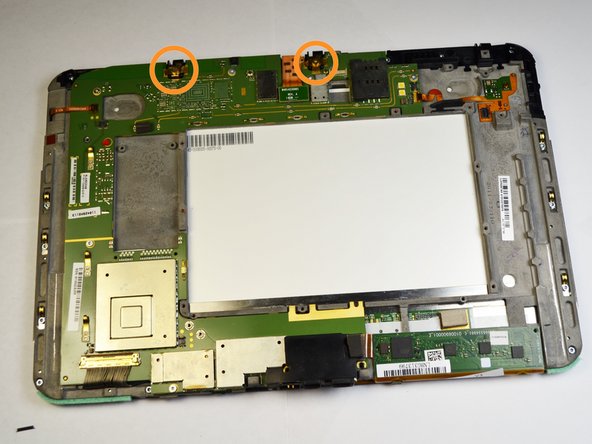

    4. Motorola Xoom Wifi Display Assembly Replacement: crwdns2935265:012crwdnd2935265:01crwdnd2935265:03crwdne2935265:0 Motorola Xoom Wifi Display Assembly Replacement: crwdns2935265:012crwdnd2935265:02crwdnd2935265:03crwdne2935265:0 Motorola Xoom Wifi Display Assembly Replacement: crwdns2935265:012crwdnd2935265:03crwdnd2935265:03crwdne2935265:0
      • There are eight 3.5mm screws that hold the motherboard in. Use a T-5 Torx screwdriver to take the screws loose. These screws are outlined in a gold color on the motherboard.
      • Two gold colored screws with brackets are located in the orange circles. A T-5 Torx screwdriver is needed to take these 3.1mm screws.
      • Motherboard should lift out easily and completely.

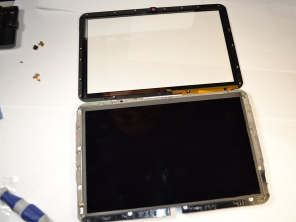

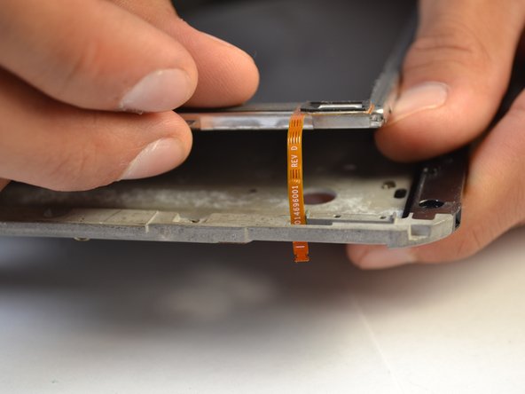

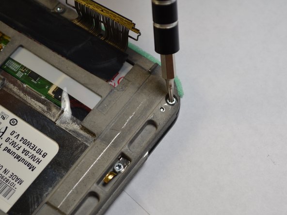

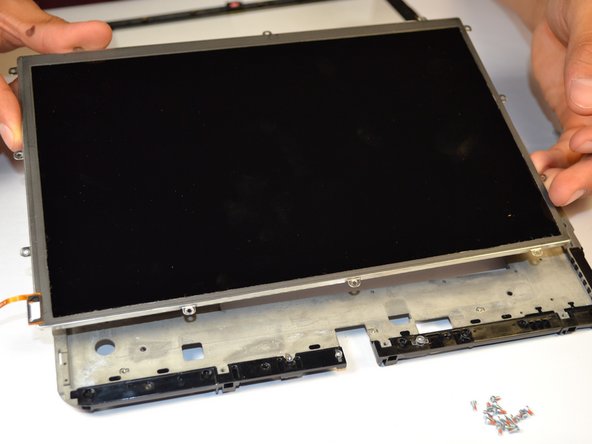

    1. Motorola Xoom Wifi Display Assembly Replacement, Display Assembly: crwdns2935265:013crwdnd2935265:01crwdnd2935265:02crwdne2935265:0 Motorola Xoom Wifi Display Assembly Replacement, Display Assembly: crwdns2935265:013crwdnd2935265:02crwdnd2935265:02crwdne2935265:0
      • Using the T-6 Torx screwdriver, unscrew the 17 4mm screws along the edge of the screen frame.
    2. Motorola Xoom Wifi Display Assembly Replacement: crwdns2935265:014crwdnd2935265:01crwdnd2935265:02crwdne2935265:0 Motorola Xoom Wifi Display Assembly Replacement: crwdns2935265:014crwdnd2935265:02crwdnd2935265:02crwdne2935265:0
      • Take the small plastic opening tool and separate the front glass from the screen frame.
      • Unfold the glass and the frame flat on the table.
    3. Motorola Xoom Wifi Display Assembly Replacement: crwdns2935265:015crwdnd2935265:01crwdnd2935265:03crwdne2935265:0 Motorola Xoom Wifi Display Assembly Replacement: crwdns2935265:015crwdnd2935265:02crwdnd2935265:03crwdne2935265:0 Motorola Xoom Wifi Display Assembly Replacement: crwdns2935265:015crwdnd2935265:03crwdnd2935265:03crwdne2935265:0
      • Using the T-5 Torx screwdriver, unscrew the 12 4.1mm screws along the edge of the screen.
      • Pull ribbon wire out of slot in the frame to pull the screen off of the frame.
