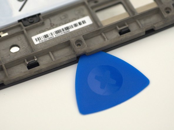

    • Turn the device over and using a pry tool and the opening picks, gently apply pressure between the outside edge of the seal marked with the arrow. Slowly move around the edges of the device, applying even pressure, and separate the back plate from the display.
    • There is adhesive between the back-plate and battery.

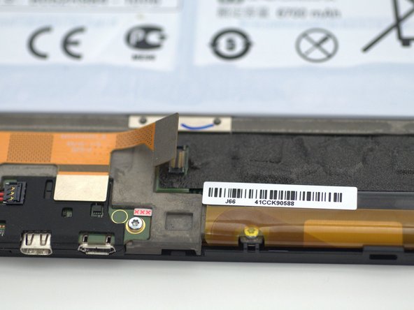

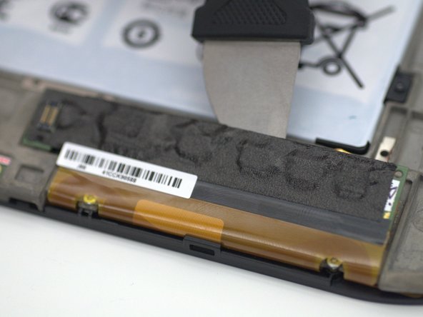

  5. Motorola Xoom 2 Screen Replacement, Screen: crwdns2935265:05crwdnd2935265:01crwdnd2935265:02crwdne2935265:0 Motorola Xoom 2 Screen Replacement, Screen: crwdns2935265:05crwdnd2935265:02crwdnd2935265:02crwdne2935265:0
    • Using a pry tool, gently un-clip the orange ribbon cable attached to the left of the digitizer connector and fold the digitizer connector away from the device.

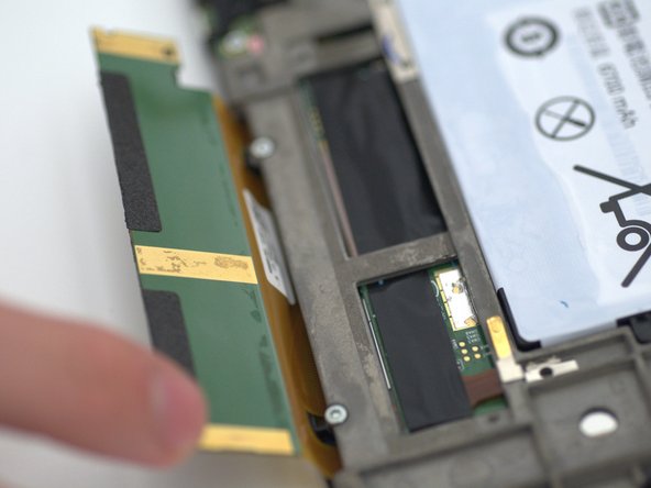

  6. Motorola Xoom 2 Screen Replacement: crwdns2935265:06crwdnd2935265:01crwdnd2935265:03crwdne2935265:0 Motorola Xoom 2 Screen Replacement: crwdns2935265:06crwdnd2935265:02crwdnd2935265:03crwdne2935265:0 Motorola Xoom 2 Screen Replacement: crwdns2935265:06crwdnd2935265:03crwdnd2935265:03crwdne2935265:0
    • Using a pry tool, gently apply force along the crevice between the digitizer board and the chassis.
    • Using your fingers, gently bend the digitizer board to the position.
    • This step is mandatory to completely remove the screen assembly.

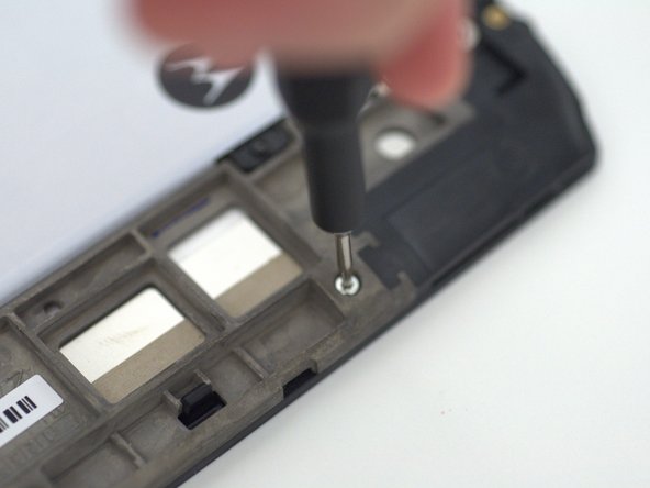

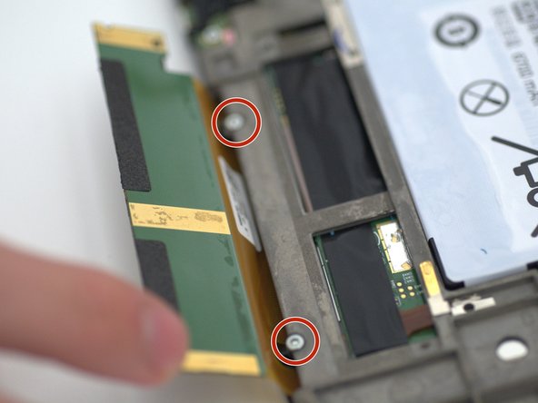

  7. Motorola Xoom 2 Screen Replacement: crwdns2935265:07crwdnd2935265:01crwdnd2935265:03crwdne2935265:0 Motorola Xoom 2 Screen Replacement: crwdns2935265:07crwdnd2935265:02crwdnd2935265:03crwdne2935265:0 Motorola Xoom 2 Screen Replacement: crwdns2935265:07crwdnd2935265:03crwdnd2935265:03crwdne2935265:0
    • Unscrew the sixteen (16) 1.5mm screws using the T5 Torx screwdriver.
    • Two of the screws were previously hidden behind the digitizer connector.
    • The screw located in the top right of the device has a washer attached.

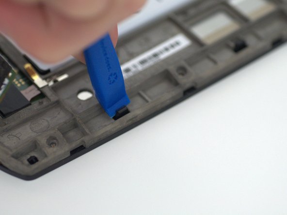

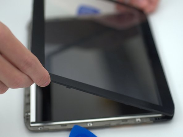

  8. Motorola Xoom 2 Screen Replacement: crwdns2935265:08crwdnd2935265:01crwdnd2935265:03crwdne2935265:0 Motorola Xoom 2 Screen Replacement: crwdns2935265:08crwdnd2935265:02crwdnd2935265:03crwdne2935265:0 Motorola Xoom 2 Screen Replacement: crwdns2935265:08crwdnd2935265:03crwdnd2935265:03crwdne2935265:0
    • Using a prying tool, unclip the four black plastic tabs on the shorter edges of the device.
    • Inserting opening picks between the digitizer and the casing may make the process easier by helping to keep the tabs un-clipped.
    • Do not touch the LCD underneath, keep it as clean as possible!

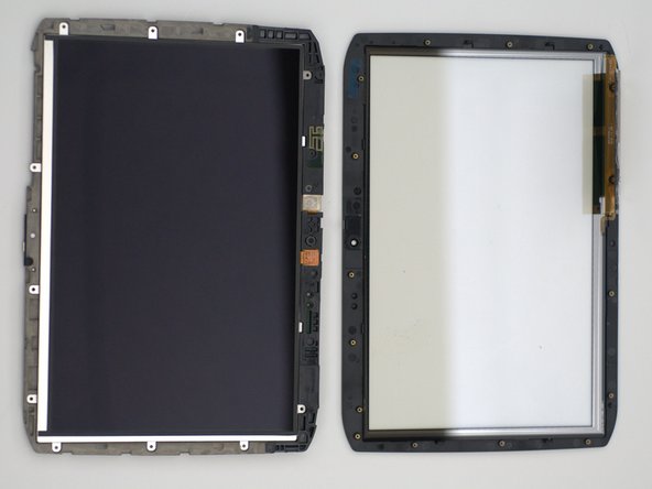

    • From here the digitizer may be replaced with a new one, the next steps continue to replace the LCD.

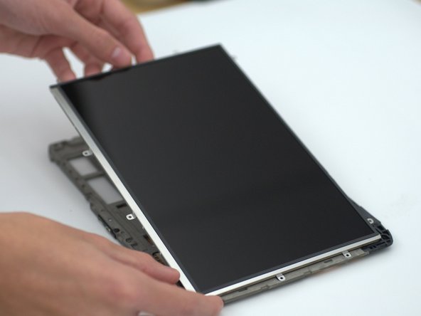

  10. Motorola Xoom 2 Screen Replacement: crwdns2935265:010crwdnd2935265:01crwdnd2935265:03crwdne2935265:0 Motorola Xoom 2 Screen Replacement: crwdns2935265:010crwdnd2935265:02crwdnd2935265:03crwdne2935265:0 Motorola Xoom 2 Screen Replacement: crwdns2935265:010crwdnd2935265:03crwdnd2935265:03crwdne2935265:0

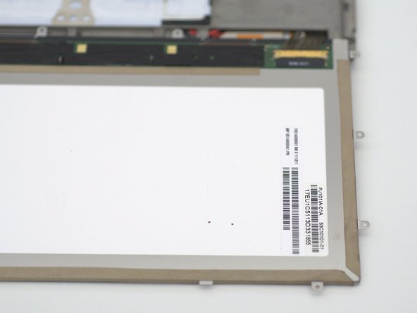

    • Using an opening pick, gently lift the LCD from the casing.
    • Holding the screw tabs with your hands, fold the LCD gently down to reveal the LCD connector located at the bottom right of the device.
    • Do not touch the LCD surface, keep it as clean as possible!
    • The LCD and the underside of the new digitizer may be cleaned by gently brushing it with a microfiber cloth.

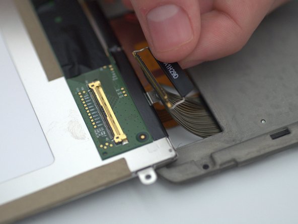

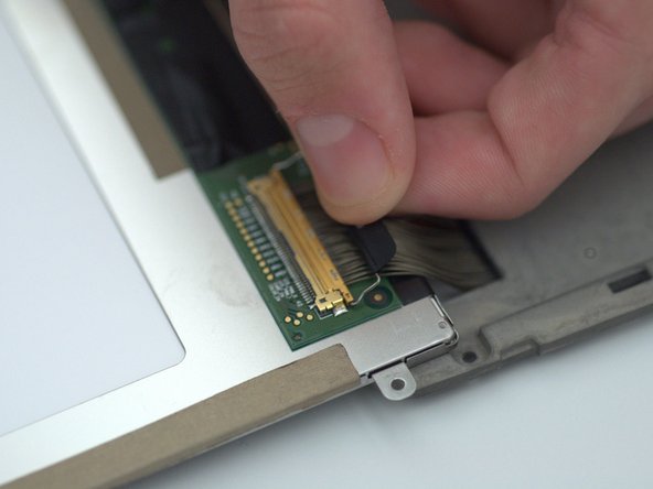

  11. Motorola Xoom 2 Screen Replacement: crwdns2935265:011crwdnd2935265:01crwdnd2935265:03crwdne2935265:0 Motorola Xoom 2 Screen Replacement: crwdns2935265:011crwdnd2935265:02crwdnd2935265:03crwdne2935265:0 Motorola Xoom 2 Screen Replacement: crwdns2935265:011crwdnd2935265:03crwdnd2935265:03crwdne2935265:0
    • Gently lift up the tab and carefully pull it straight back, parallel to the cable, until the LCD cable is removed.
    • Slightly wiggling the tab can help to ease the connector apart.
    • Do not use excessive force to remove the connector, this risks the pins getting damaged rendering the cable and/or LCD unusable.
