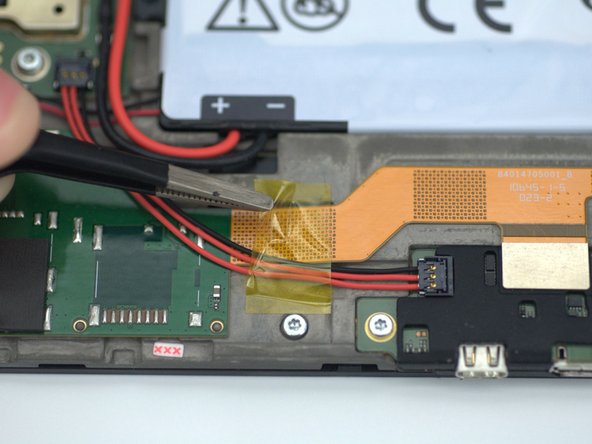

  5. Motorola Xoom 2 Charging Port Replacement, Charging Port: crwdns2935265:05crwdnd2935265:01crwdnd2935265:02crwdne2935265:0 Motorola Xoom 2 Charging Port Replacement, Charging Port: crwdns2935265:05crwdnd2935265:02crwdnd2935265:02crwdne2935265:0
    • Using tweezers, gently pry up the piece of yellow Kapton tape that is holding several cables in place.
    • Set this piece of tape aside, as it is required for reassembly.
  6. Motorola Xoom 2 Charging Port Replacement: crwdns2935265:06crwdnd2935265:01crwdnd2935265:03crwdne2935265:0 Motorola Xoom 2 Charging Port Replacement: crwdns2935265:06crwdnd2935265:02crwdnd2935265:03crwdne2935265:0 Motorola Xoom 2 Charging Port Replacement: crwdns2935265:06crwdnd2935265:03crwdnd2935265:03crwdne2935265:0

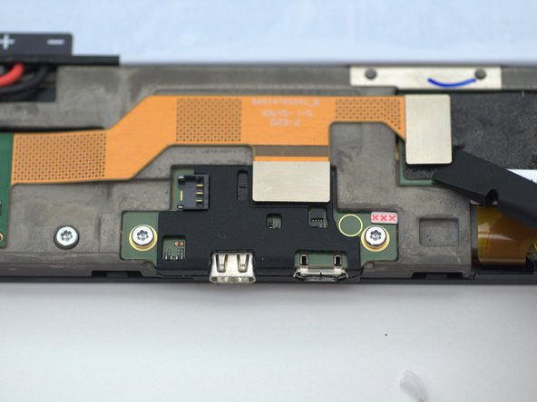

    • Using a spudger, carefully disconnect the 3 pin cable.
    • The 3 pin cable connectors are made of soft, easily breakable plastic. Take care not to use unnecessary force during repair.
    • Then carefully disconnect the flat yellow ribbon cable at both connection points.

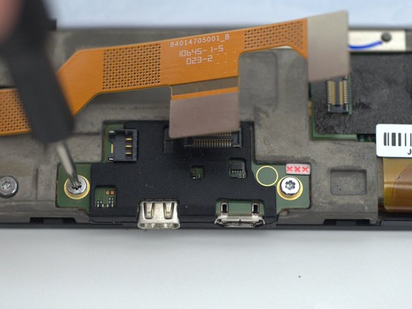

  7. Motorola Xoom 2 Charging Port Replacement: crwdns2935265:07crwdnd2935265:01crwdnd2935265:02crwdne2935265:0 Motorola Xoom 2 Charging Port Replacement: crwdns2935265:07crwdnd2935265:02crwdnd2935265:02crwdne2935265:0
    • Using a Torx T5 driver bit, unscrew the two 1.5mm screws holding down the charging port assembly.

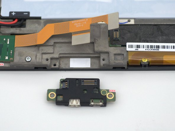

  8. Motorola Xoom 2 Charging Port Replacement: crwdns2935265:08crwdnd2935265:01crwdnd2935265:02crwdne2935265:0 Motorola Xoom 2 Charging Port Replacement: crwdns2935265:08crwdnd2935265:02crwdnd2935265:02crwdne2935265:0
    • Using a spudger, gently apply pressure between the chassis and charging port assembly to remove it.
    • The charging port should be free from the chassis and require little to no force to remove.
    • The rubber jacket covering the charging port assembly may need to be removed and reused, depending on whether or not the replacement comes with another one.
