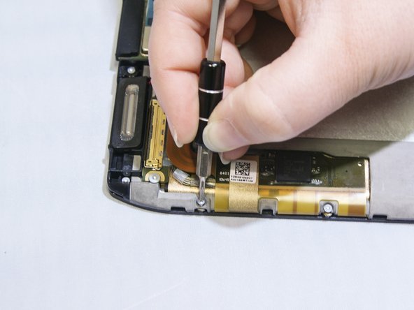

  4. Motorola XOOM 2 Media Edition Touch Screen Replacement, Touch Screen: crwdns2935265:04crwdnd2935265:01crwdnd2935265:02crwdne2935265:0 Motorola XOOM 2 Media Edition Touch Screen Replacement, Touch Screen: crwdns2935265:04crwdnd2935265:02crwdnd2935265:02crwdne2935265:0
    • Remove thirteen 2.55mm Torx #4 screws with Torx T4 screwdriver.

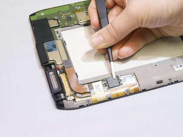

  5. Motorola XOOM 2 Media Edition Touch Screen Replacement: crwdns2935265:05crwdnd2935265:01crwdnd2935265:01crwdne2935265:0
    • Use tweezers to pull up the white rubber cover.
  6. Motorola XOOM 2 Media Edition Touch Screen Replacement: crwdns2935265:06crwdnd2935265:01crwdnd2935265:03crwdne2935265:0 Motorola XOOM 2 Media Edition Touch Screen Replacement: crwdns2935265:06crwdnd2935265:02crwdnd2935265:03crwdne2935265:0 Motorola XOOM 2 Media Edition Touch Screen Replacement: crwdns2935265:06crwdnd2935265:03crwdnd2935265:03crwdne2935265:0
    • Use the tweezers to pull up the small chip from its receiver.
    • Use the tweezers to pull up the larger chip from its receiver.
    • There is adhesive attached to the back of the larger chip on the touchscreen controller strip.
    • Use the tweezers to pull up one end of the small piece of tape that is holding the touchscreen controller.

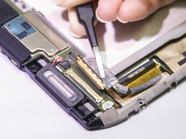

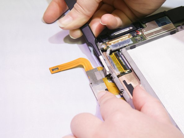

  7. Motorola XOOM 2 Media Edition Touch Screen Replacement: crwdns2935265:07crwdnd2935265:01crwdnd2935265:02crwdne2935265:0 Motorola XOOM 2 Media Edition Touch Screen Replacement: crwdns2935265:07crwdnd2935265:02crwdnd2935265:02crwdne2935265:0
    • Use the tweezers to pull up and release the thin handle that is attached to the LCD connector.
    • Use the tweezers to pull out the LCD connector from its receptor.

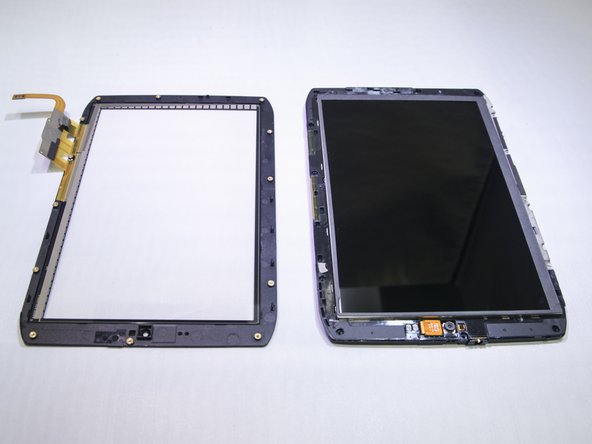

  8. Motorola XOOM 2 Media Edition Touch Screen Replacement: crwdns2935265:08crwdnd2935265:01crwdnd2935265:02crwdne2935265:0 Motorola XOOM 2 Media Edition Touch Screen Replacement: crwdns2935265:08crwdnd2935265:02crwdnd2935265:02crwdne2935265:0
    • Use a plastic opening tool to gradually separate the screen from the device.
