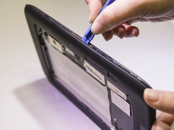

  2. Motorola XOOM 2 Media Edition Speakers Replacement: crwdns2935265:02crwdnd2935265:01crwdnd2935265:02crwdne2935265:0 Motorola XOOM 2 Media Edition Speakers Replacement: crwdns2935265:02crwdnd2935265:02crwdnd2935265:02crwdne2935265:0
    • There is adhesive attached to the underside of the back panel. Gradually lift the panel to avoid bending it out of shape.
    • Pry off the back panel using a plastic opening tool.
    • Using a plastic opening tool, slide the tool gently around the back cover to lift the cover off.

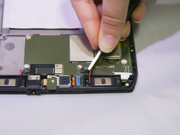

  3. Motorola XOOM 2 Media Edition Speakers Replacement: crwdns2935265:03crwdnd2935265:01crwdnd2935265:03crwdne2935265:0 Motorola XOOM 2 Media Edition Speakers Replacement: crwdns2935265:03crwdnd2935265:02crwdnd2935265:03crwdne2935265:0 Motorola XOOM 2 Media Edition Speakers Replacement: crwdns2935265:03crwdnd2935265:03crwdnd2935265:03crwdne2935265:0
    • Pry off the black cover gradually using a plastic opening tool.

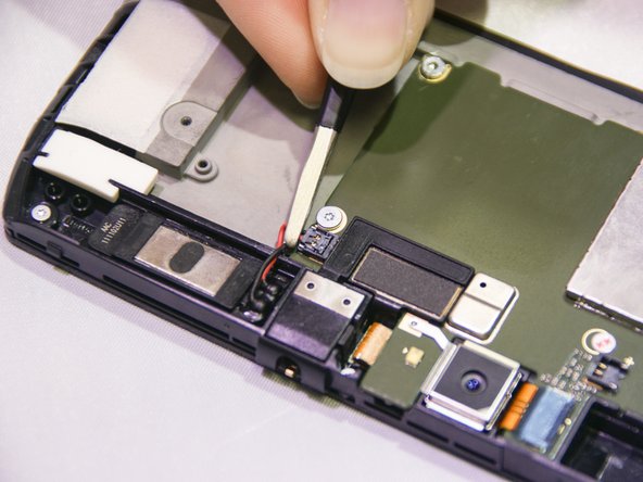

  4. Motorola XOOM 2 Media Edition Speakers Replacement, Speakers: crwdns2935265:04crwdnd2935265:01crwdnd2935265:03crwdne2935265:0 Motorola XOOM 2 Media Edition Speakers Replacement, Speakers: crwdns2935265:04crwdnd2935265:02crwdnd2935265:03crwdne2935265:0 Motorola XOOM 2 Media Edition Speakers Replacement, Speakers: crwdns2935265:04crwdnd2935265:03crwdnd2935265:03crwdne2935265:0
    • Using the tweezers, gently pull up the connector of each of the speakers.

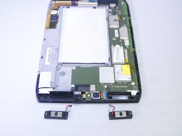

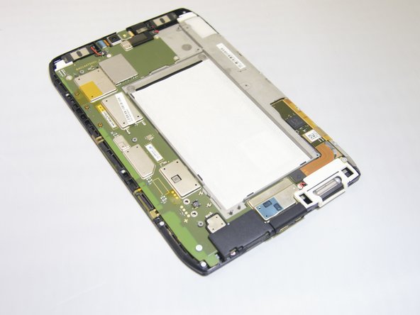

  5. Motorola XOOM 2 Media Edition Speakers Replacement: crwdns2935265:05crwdnd2935265:01crwdnd2935265:02crwdne2935265:0 Motorola XOOM 2 Media Edition Speakers Replacement: crwdns2935265:05crwdnd2935265:02crwdnd2935265:02crwdne2935265:0
    • Once the connector is removed, use the tweezers to pull up the speaker from its plastic socket on both of the speakers.
