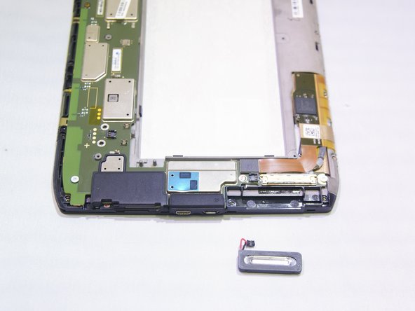

  5. Motorola XOOM 2 Media Edition Microphone Replacement: crwdns2935265:05crwdnd2935265:01crwdnd2935265:01crwdne2935265:0
    • Using the tweezers, gently pull up the connector off the microphone.
  6. Motorola XOOM 2 Media Edition Microphone Replacement: crwdns2935265:06crwdnd2935265:01crwdnd2935265:02crwdne2935265:0 Motorola XOOM 2 Media Edition Microphone Replacement: crwdns2935265:06crwdnd2935265:02crwdnd2935265:02crwdne2935265:0
    • Once the connector is removed, use the tweezers to pull up the microphone from its plastic socket.
