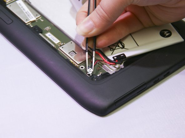

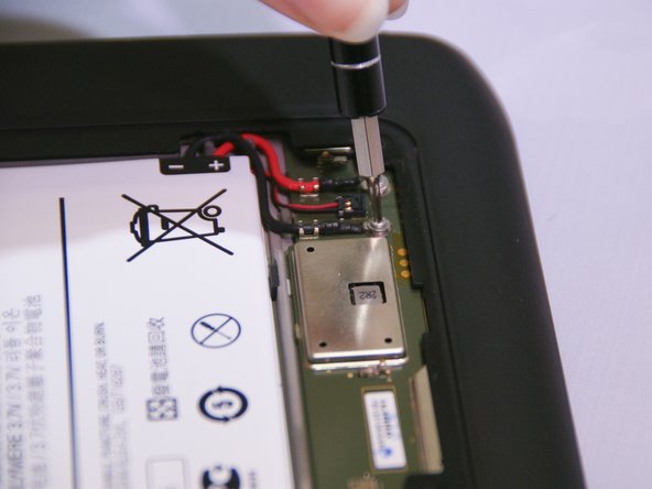

  3. Motorola XOOM 2 Media Edition Battery Replacement: crwdns2935265:03crwdnd2935265:01crwdnd2935265:02crwdne2935265:0 Motorola XOOM 2 Media Edition Battery Replacement: crwdns2935265:03crwdnd2935265:02crwdnd2935265:02crwdne2935265:0
    • These screws are tight and prone to becoming stripped.
    • The battery cables are likely to snap when removing the screws.
    • Remove two 2.38mm Torx #5 screws from battery cables with Torx T5 screwdriver.

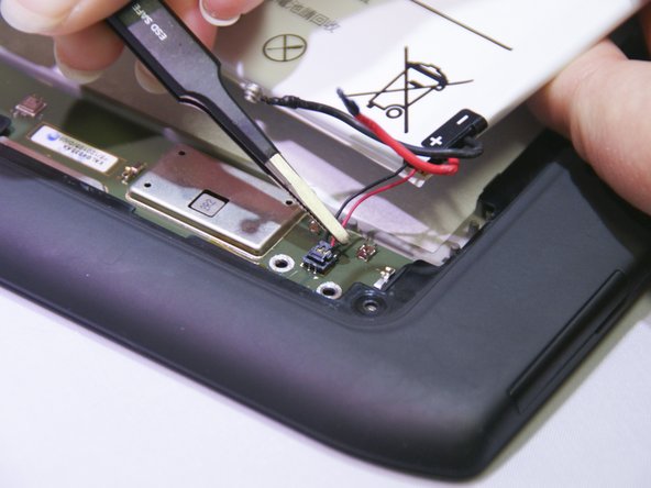

  4. Motorola XOOM 2 Media Edition Battery Replacement: crwdns2935265:04crwdnd2935265:01crwdnd2935265:03crwdne2935265:0 Motorola XOOM 2 Media Edition Battery Replacement: crwdns2935265:04crwdnd2935265:02crwdnd2935265:03crwdne2935265:0 Motorola XOOM 2 Media Edition Battery Replacement: crwdns2935265:04crwdnd2935265:03crwdnd2935265:03crwdne2935265:0
    • Pull up the battery cables and battery chip with tweezers.

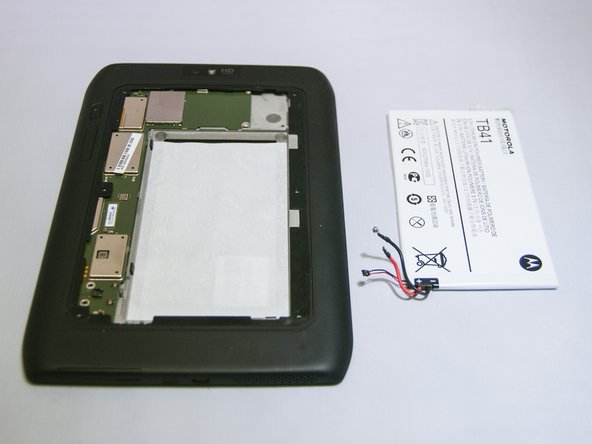

  5. Motorola XOOM 2 Media Edition Battery Replacement: crwdns2935265:05crwdnd2935265:01crwdnd2935265:02crwdne2935265:0 Motorola XOOM 2 Media Edition Battery Replacement: crwdns2935265:05crwdnd2935265:02crwdnd2935265:02crwdne2935265:0
    • Pry the battery out of the device with the plastic opening tool.
    • Some force is needed to lift the battery up because of the adhesive attached to the backside of the battery.
