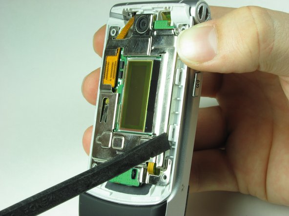

  7. Motorola W385 Top Logic Board Replacement, Top Logic Board: crwdns2935265:07crwdnd2935265:01crwdnd2935265:01crwdne2935265:0
    • After completing Steps 3-6 in the casing repair guide, your phone should look like this.
  8. Motorola W385 Top Logic Board Replacement: crwdns2935265:08crwdnd2935265:01crwdnd2935265:03crwdne2935265:0 Motorola W385 Top Logic Board Replacement: crwdns2935265:08crwdnd2935265:02crwdnd2935265:03crwdne2935265:0 Motorola W385 Top Logic Board Replacement: crwdns2935265:08crwdnd2935265:03crwdnd2935265:03crwdne2935265:0

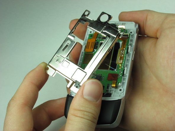

    • Use the spudger to unhinge the four clips around the metal casing of the top logic board.
    • Gently take off the metal casing of the logic board.
