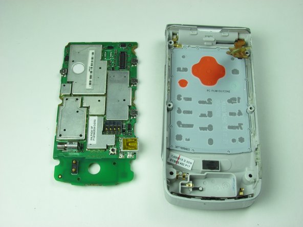

  8. Motorola W385 Logic Board Replacement: crwdns2935265:08crwdnd2935265:01crwdnd2935265:01crwdne2935265:0
    • The casing can be easily removed exposing the bottom logic board.

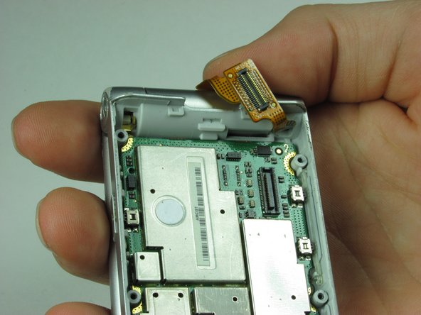

  9. Motorola W385 Logic Board Replacement, Main Logic Board: crwdns2935265:09crwdnd2935265:01crwdnd2935265:02crwdne2935265:0 Motorola W385 Logic Board Replacement, Main Logic Board: crwdns2935265:09crwdnd2935265:02crwdnd2935265:02crwdne2935265:0
    • Use spudger to gently separate the ribbon cable from the logic board.
  10. Motorola W385 Logic Board Replacement: crwdns2935265:010crwdnd2935265:01crwdnd2935265:02crwdne2935265:0 Motorola W385 Logic Board Replacement: crwdns2935265:010crwdnd2935265:02crwdnd2935265:02crwdne2935265:0
    • Place the sharp end of the spudger in the hole at the bottom of the logic board.
    • Gently remove the logic board from the phone casing.
    • Make sure not to damage any other components of the logic board.
