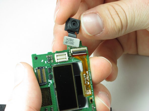

  10. Motorola W385 Camera Replacement, Camera: crwdns2935265:010crwdnd2935265:01crwdnd2935265:01crwdne2935265:0
    • Find the camera on the board.
  11. Motorola W385 Camera Replacement: crwdns2935265:011crwdnd2935265:01crwdnd2935265:02crwdne2935265:0 Motorola W385 Camera Replacement: crwdns2935265:011crwdnd2935265:02crwdnd2935265:02crwdne2935265:0
    • Take your spudger and place it just under the camera as shown.
    • With a small force, the camera should remove easily.
