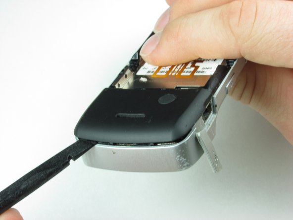

  4. Motorola W385 Bottom Casing Replacement: crwdns2935265:04crwdnd2935265:01crwdnd2935265:02crwdne2935265:0 Motorola W385 Bottom Casing Replacement: crwdns2935265:04crwdnd2935265:02crwdnd2935265:02crwdne2935265:0
    • Using the flat side of the spudger and a little pressure, insert it under the bottom plastic piece at about center.
    • This might require a little persistence due how the beveled plastic rests on the phone body.
    • After the spudger is under the plastic piece, move counter clockwise using a gentle twisting motion until the piece is free from the phone body.

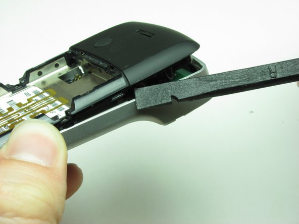

  7. Motorola W385 Bottom Casing Replacement: crwdns2935265:07crwdnd2935265:01crwdnd2935265:03crwdne2935265:0 Motorola W385 Bottom Casing Replacement: crwdns2935265:07crwdnd2935265:02crwdnd2935265:03crwdne2935265:0 Motorola W385 Bottom Casing Replacement: crwdns2935265:07crwdnd2935265:03crwdnd2935265:03crwdne2935265:0
    • Hold the phone with the keys facing down and the mini USB charging port visible.
    • Open the rubber flap covering the charging port.
    • Insert the flat end of the spudger just above the charging port.
    • Using the same gentle twisting motion, work around the bottom of the phone and up the opposite side. The back casing should separate from the body of the phone.
    • When working on the thinner pieces of the plastic casing, use caution insuring the plastic does not crack.
