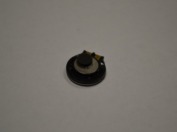

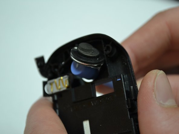

  5. Motorola W315 Speaker Replacement, Speaker: crwdns2935265:06crwdnd2935265:01crwdnd2935265:03crwdne2935265:0 Motorola W315 Speaker Replacement, Speaker: crwdns2935265:06crwdnd2935265:02crwdnd2935265:03crwdne2935265:0 Motorola W315 Speaker Replacement, Speaker: crwdns2935265:06crwdnd2935265:03crwdnd2935265:03crwdne2935265:0
    • Using back of the plastic opening tool, push the speaker out of the casing.
    • Remove existing speaker.
    • Replace with new speaker
