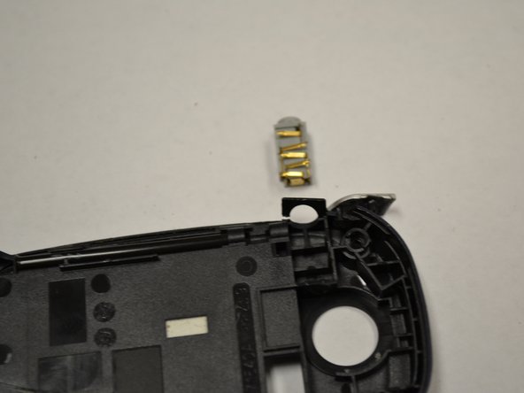

  5. Motorola W315 Headphone Jack Replacement, Headphone Jack: crwdns2935265:06crwdnd2935265:01crwdnd2935265:02crwdne2935265:0 Motorola W315 Headphone Jack Replacement, Headphone Jack: crwdns2935265:06crwdnd2935265:02crwdnd2935265:02crwdne2935265:0
    • Use the pry bar to carefully remove the headphone jack.
