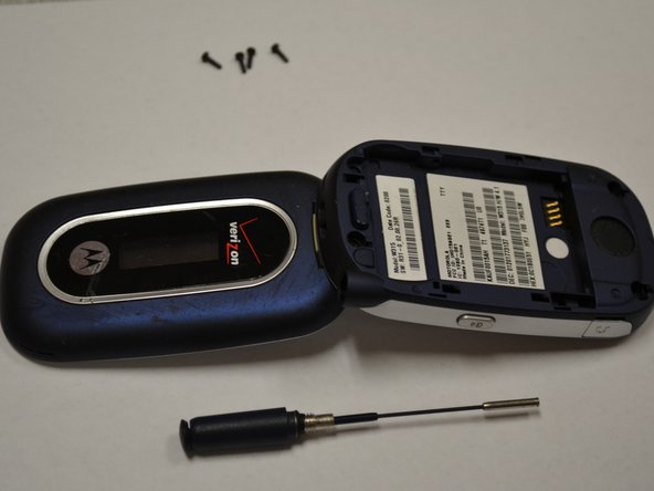

  3. Motorola W315 Antenna Replacement, Rear Case: crwdns2935265:04crwdnd2935265:01crwdnd2935265:01crwdne2935265:0
    • Four 5 mm screws are visible (circled in red).
    • Using the T6 tool, remove all four 5mm screws and set them aside.

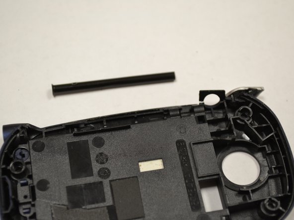

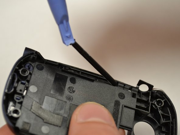

  5. Motorola W315 Antenna Replacement, Antenna: crwdns2935265:06crwdnd2935265:01crwdnd2935265:01crwdne2935265:0
    • Gently twist the antenna in a counter-clockwise direction to unscrew it.
  6. Motorola W315 Antenna Replacement: crwdns2935265:07crwdnd2935265:01crwdnd2935265:02crwdne2935265:0 Motorola W315 Antenna Replacement: crwdns2935265:07crwdnd2935265:02crwdnd2935265:02crwdne2935265:0
    • Pull the antenna out through the hole in the top of the frame and set it aside.
  7. Motorola W315 Antenna Replacement: crwdns2935265:08crwdnd2935265:01crwdnd2935265:03crwdne2935265:0 Motorola W315 Antenna Replacement: crwdns2935265:08crwdnd2935265:02crwdnd2935265:03crwdne2935265:0 Motorola W315 Antenna Replacement: crwdns2935265:08crwdnd2935265:03crwdnd2935265:03crwdne2935265:0
    • Using a plastic opening tool, lift and remove the antenna casing.
