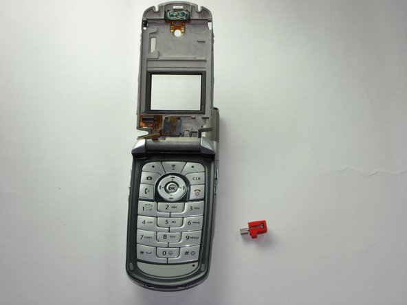

    • Insert the spudger between the gray and black plates of the screen casing.
    • Using a twist and pry motion work your way around the phone slowly prying the two plates apart.
    • Note: this part of the phone is glued and will require re-gluing to return the phone to its original state.
  2. Motorola V710 Vibrating Motor Replacement: crwdns2935265:02crwdnd2935265:01crwdnd2935265:02crwdne2935265:0 Motorola V710 Vibrating Motor Replacement: crwdns2935265:02crwdnd2935265:02crwdnd2935265:02crwdne2935265:0
    • If you look at the side of the now exposed screen there should be a metal casing held onto the phone by two tabs.
    • Insert the spudger underneath one of the corners of the metal and bend it out enough to slip it over the tabs.
    • This metal is reasonably resistant to bending and will likely require a good deal of force to get it off the phone.
  3. Motorola V710 Vibrating Motor Replacement: crwdns2935265:03crwdnd2935265:01crwdnd2935265:02crwdne2935265:0 Motorola V710 Vibrating Motor Replacement: crwdns2935265:03crwdnd2935265:02crwdnd2935265:02crwdne2935265:0
    • Orient the phone so that the main screen is facing upward.
    • Locate the hinge casing, a dark gray piece that covers the hinge.
    • Insert the spudger under one of the top corners of this piece and using a twist and pry motion remove from the phone.
  4. Motorola V710 Vibrating Motor Replacement: crwdns2935265:04crwdnd2935265:01crwdnd2935265:02crwdne2935265:0 Motorola V710 Vibrating Motor Replacement: crwdns2935265:04crwdnd2935265:02crwdnd2935265:02crwdne2935265:0
    • Use the spudger to pry upward and remove the plug that connects the screen to the main body of the phone.
  5. Motorola V710 Vibrating Motor Replacement: crwdns2935265:05crwdnd2935265:01crwdnd2935265:02crwdne2935265:0 Motorola V710 Vibrating Motor Replacement: crwdns2935265:05crwdnd2935265:02crwdnd2935265:02crwdne2935265:0
    • Insert the spudger under the screen and pry the screen forward.
    • Remove the plug on the back of the screen that connects it to the camera.
  6. Motorola V710 Vibrating Motor Replacement: crwdns2935265:06crwdnd2935265:01crwdnd2935265:02crwdne2935265:0 Motorola V710 Vibrating Motor Replacement: crwdns2935265:06crwdnd2935265:02crwdnd2935265:02crwdne2935265:0
    • Use the spudger to remove the screen.
  7. Motorola V710 Vibrating Motor Replacement, Vibrating Motor: crwdns2935265:07crwdnd2935265:01crwdnd2935265:02crwdne2935265:0 Motorola V710 Vibrating Motor Replacement, Vibrating Motor: crwdns2935265:07crwdnd2935265:02crwdnd2935265:02crwdne2935265:0
    • Remove the vibrating motor from the phone with the spudger.
