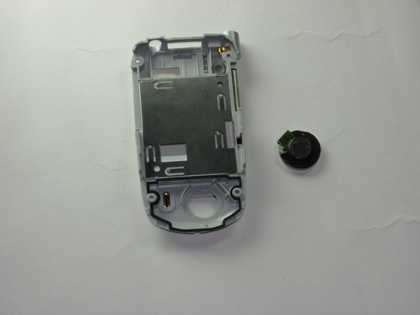

  11. Motorola V710 Speaker Replacement, Replacing Speaker: crwdns2935265:011crwdnd2935265:01crwdnd2935265:02crwdne2935265:0 Motorola V710 Speaker Replacement, Replacing Speaker: crwdns2935265:011crwdnd2935265:02crwdnd2935265:02crwdne2935265:0
    • Use the spudger take the speaker out.
