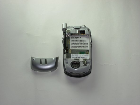

    • Press down on the back button while pulling away from the body of the phone to release the back cover.
  2. Motorola V710 Logic Board Replacement: crwdns2935265:02crwdnd2935265:01crwdnd2935265:03crwdne2935265:0 Motorola V710 Logic Board Replacement: crwdns2935265:02crwdnd2935265:02crwdnd2935265:03crwdne2935265:0 Motorola V710 Logic Board Replacement: crwdns2935265:02crwdnd2935265:03crwdnd2935265:03crwdne2935265:0
    • Remove the battery from the phone by gently pulling upward on the battery with your fingers.

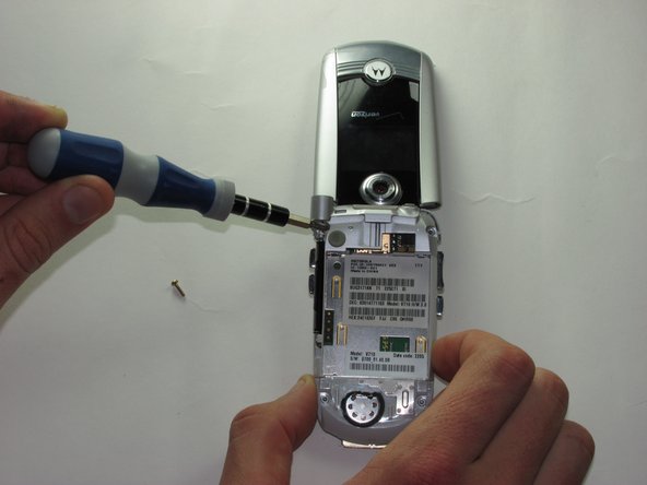

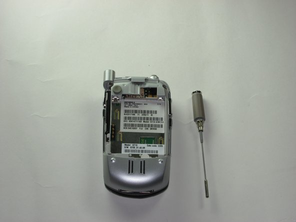

    • Unscrew and remove the antenna by gripping the base and twisting clockwise.
    • Once the antenna has passed the threading, pull out.
  4. Motorola V710 Logic Board Replacement: crwdns2935265:04crwdnd2935265:01crwdnd2935265:02crwdne2935265:0 Motorola V710 Logic Board Replacement: crwdns2935265:04crwdnd2935265:02crwdnd2935265:02crwdne2935265:0
    • Remove the screws from the upper side of the phone with the T6 Torx screwdriver.
    • The first screw is underneath where the antenna was and the other is visible to the right.

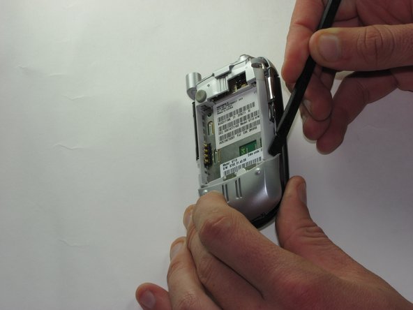

    • Insert the spudger under the left corner of the bottom plate.
    • Using a twist and pry motion seperate the bottom plate and work your way to the right.
    • This can be somewhat difficult and require a good deal of work.

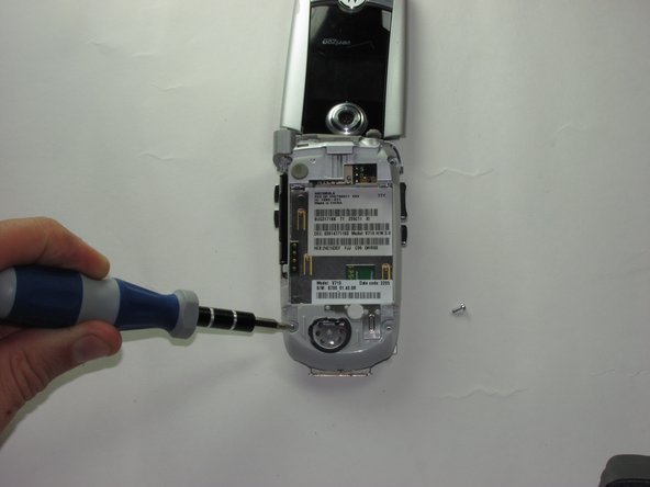

  6. Motorola V710 Logic Board Replacement: crwdns2935265:06crwdnd2935265:01crwdnd2935265:02crwdne2935265:0 Motorola V710 Logic Board Replacement: crwdns2935265:06crwdnd2935265:02crwdnd2935265:02crwdne2935265:0
    • Use the T6 Torx screwdriver to remove the bottom two screws.

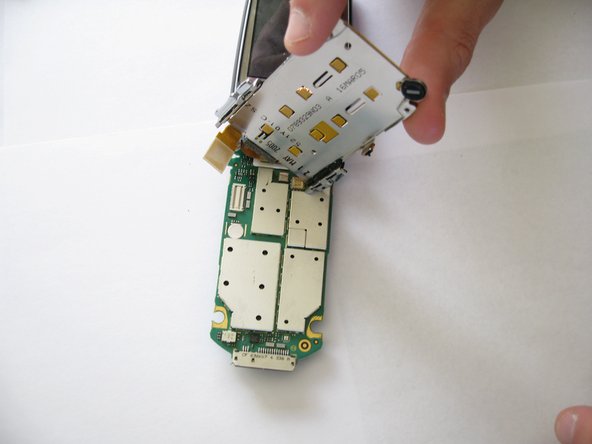

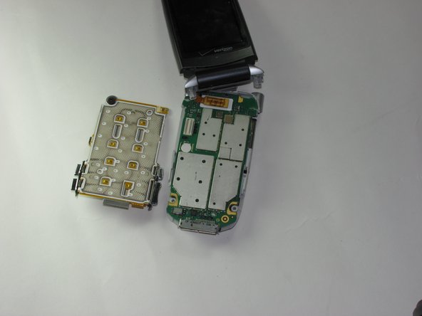

  8. Motorola V710 Logic Board Replacement: crwdns2935265:08crwdnd2935265:01crwdnd2935265:03crwdne2935265:0 Motorola V710 Logic Board Replacement: crwdns2935265:08crwdnd2935265:02crwdnd2935265:03crwdne2935265:0 Motorola V710 Logic Board Replacement: crwdns2935265:08crwdnd2935265:03crwdnd2935265:03crwdne2935265:0
    • Pull the pressure plate forward to expose the logic board.
    • Use the spludger to pry off the plug that connects pressure pad to the logic board.
    • Remove the pressure pad.
  9. Motorola V710 Logic Board Replacement: crwdns2935265:09crwdnd2935265:01crwdnd2935265:01crwdne2935265:0
    • Use the spudger to pry off the plug that connects logic board to the screen.
  10. Motorola V710 Logic Board Replacement: crwdns2935265:010crwdnd2935265:01crwdnd2935265:02crwdne2935265:0 Motorola V710 Logic Board Replacement: crwdns2935265:010crwdnd2935265:02crwdnd2935265:02crwdne2935265:0
    • Remove the logic board.
