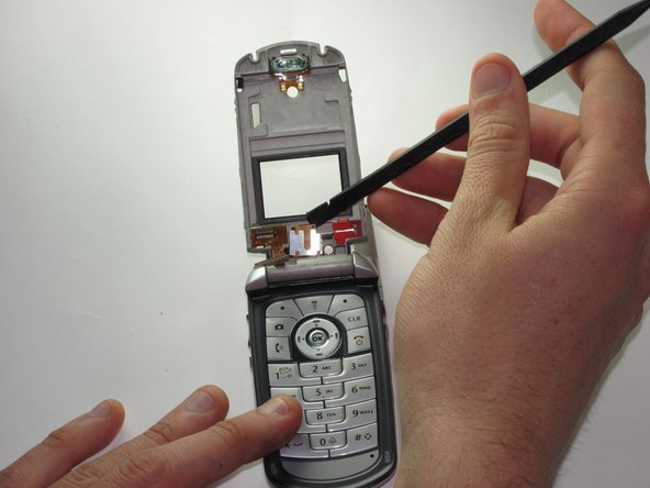

  4. Motorola V710 Camera Replacement: crwdns2935265:04crwdnd2935265:01crwdnd2935265:02crwdne2935265:0 Motorola V710 Camera Replacement: crwdns2935265:04crwdnd2935265:02crwdnd2935265:02crwdne2935265:0
    • Use the spudger to pry upward and remove the plug that connects the screen to the main body of the phone.
  5. Motorola V710 Camera Replacement: crwdns2935265:05crwdnd2935265:01crwdnd2935265:02crwdne2935265:0 Motorola V710 Camera Replacement: crwdns2935265:05crwdnd2935265:02crwdnd2935265:02crwdne2935265:0

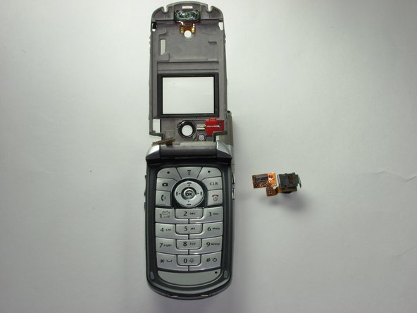

  7. Motorola V710 Camera Replacement, Camera: crwdns2935265:07crwdnd2935265:01crwdnd2935265:03crwdne2935265:0 Motorola V710 Camera Replacement, Camera: crwdns2935265:07crwdnd2935265:02crwdnd2935265:03crwdne2935265:0 Motorola V710 Camera Replacement, Camera: crwdns2935265:07crwdnd2935265:03crwdnd2935265:03crwdne2935265:0
    • Use the spudger to remove the camera module.
    • Note: The camera has an adhesive holding it in place, so a slight force is necessary to remove it.
