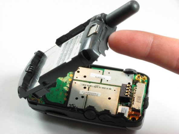

    • Push in release lever towards top of phone, then use blue spudger to pry case off.
    • After case is removed from the back of the phone, you can simply use your hands to take it the rest of the way off.
    • Set cover aside in a safe location.
  2. Motorola V60s Speakers Replacement: crwdns2935265:02crwdnd2935265:01crwdnd2935265:02crwdne2935265:0 Motorola V60s Speakers Replacement: crwdns2935265:02crwdnd2935265:02crwdnd2935265:02crwdne2935265:0
    • Carefully grab battery towards bottom of phone.
    • Lift from bottom and take out of phone, set aside in a safe location.

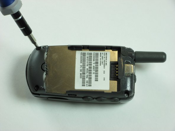

  3. Motorola V60s Speakers Replacement, Speakers: crwdns2935265:03crwdnd2935265:01crwdnd2935265:02crwdne2935265:0 Motorola V60s Speakers Replacement, Speakers: crwdns2935265:03crwdnd2935265:02crwdnd2935265:02crwdne2935265:0
    • Remove the four screws using a T6 Torx screwdriver.
    • Top screws are silver and short while bottom screws are black and longer.
