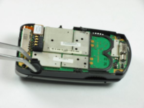

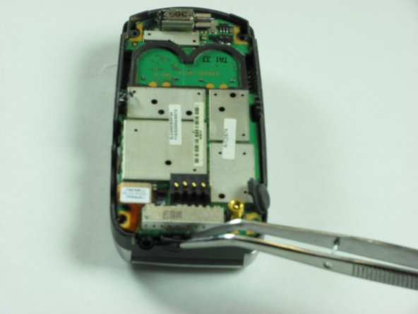

    • Starting from left side of phone, remove side buttons and place aside.
    • There are three buttons. One on each side, and the top.
    • Return phone to starting orientation when done.
  6. Motorola V60s Button Key Pad Replacement: crwdns2935265:06crwdnd2935265:01crwdnd2935265:03crwdne2935265:0 Motorola V60s Button Key Pad Replacement: crwdns2935265:06crwdnd2935265:02crwdnd2935265:03crwdne2935265:0 Motorola V60s Button Key Pad Replacement: crwdns2935265:06crwdnd2935265:03crwdnd2935265:03crwdne2935265:0
    • Gently remove orange ribbon cable by prying up with spudger.

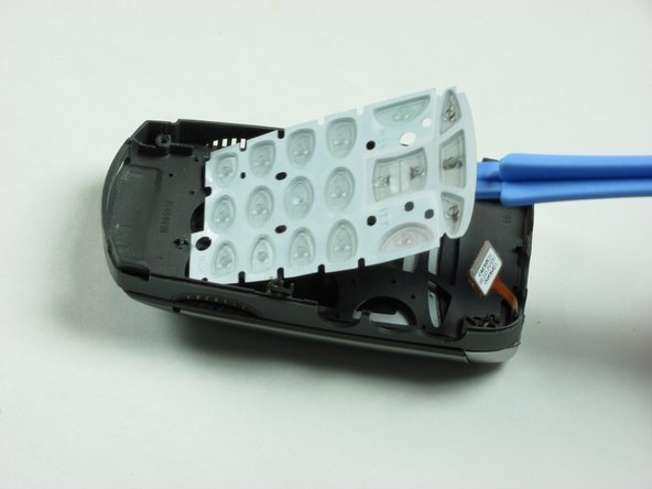

  8. Motorola V60s Button Key Pad Replacement, Button Key Board: crwdns2935265:08crwdnd2935265:01crwdnd2935265:02crwdne2935265:0 Motorola V60s Button Key Pad Replacement, Button Key Board: crwdns2935265:08crwdnd2935265:02crwdnd2935265:02crwdne2935265:0
    • Insert an opening tool under the button board and gently lift.
  9. Motorola V60s Button Key Pad Replacement, Button Key Pad: crwdns2935265:09crwdnd2935265:01crwdnd2935265:02crwdne2935265:0 Motorola V60s Button Key Pad Replacement, Button Key Pad: crwdns2935265:09crwdnd2935265:02crwdnd2935265:02crwdne2935265:0
    • Life button keypad with spudger and set aside.
