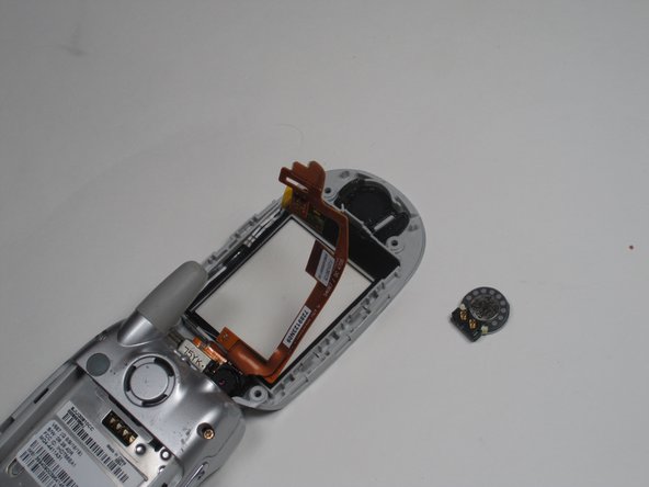

  14. Motorola V557 Internal Speaker Replacement, Internal Speaker: crwdns2935265:014crwdnd2935265:01crwdnd2935265:02crwdne2935265:0 Motorola V557 Internal Speaker Replacement, Internal Speaker: crwdns2935265:014crwdnd2935265:02crwdnd2935265:02crwdne2935265:0
    • Pry the speaker out of the case by wedging a pin under the wire mesh.
    • The speaker is glued to the case. It will take some effort to remove, but don't worry, it is not fragile.
