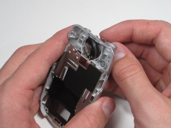

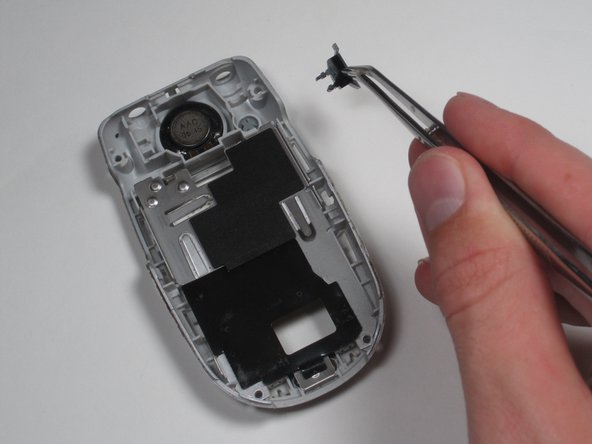

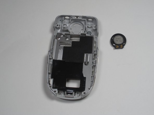

  9. Motorola V557 External Speaker Replacement, External Speaker: crwdns2935265:09crwdnd2935265:01crwdnd2935265:02crwdne2935265:0 Motorola V557 External Speaker Replacement, External Speaker: crwdns2935265:09crwdnd2935265:02crwdnd2935265:02crwdne2935265:0
    • Using metal tweezers, lift out the black plastic support piece from beneath the headphone jack.
  10. Motorola V557 External Speaker Replacement: crwdns2935265:010crwdnd2935265:01crwdnd2935265:03crwdne2935265:0 Motorola V557 External Speaker Replacement: crwdns2935265:010crwdnd2935265:02crwdnd2935265:03crwdne2935265:0 Motorola V557 External Speaker Replacement: crwdns2935265:010crwdnd2935265:03crwdnd2935265:03crwdne2935265:0
    • Separate the speaker from the casing by pushing with a pin from the back (external) side, through the openings in the casing.
    • Be gentle! The wire mesh is durable, but it might suffer damage if you push too hard with the pin.
