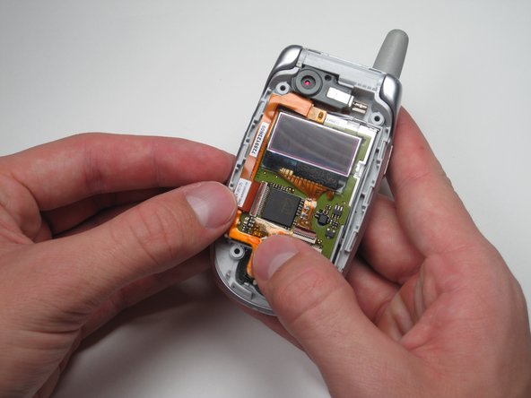

    4. Motorola V557 Camera Replacement: crwdns2935265:010crwdnd2935265:01crwdnd2935265:02crwdne2935265:0 Motorola V557 Camera Replacement: crwdns2935265:010crwdnd2935265:02crwdnd2935265:02crwdne2935265:0
      • Using a plastic opening tool, pry or lift open the pink door shown.
      • After the door is open, gently pull on the ribbon cable's corner to separate it from the board.
      • Work out the ribbon cable's end slowly and gently to avoid damaging the pink door port.

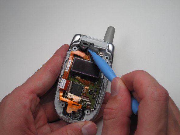

    5. Motorola V557 Camera Replacement: crwdns2935265:011crwdnd2935265:01crwdnd2935265:03crwdne2935265:0 Motorola V557 Camera Replacement: crwdns2935265:011crwdnd2935265:02crwdnd2935265:03crwdne2935265:0 Motorola V557 Camera Replacement: crwdns2935265:011crwdnd2935265:03crwdnd2935265:03crwdne2935265:0
      • Use a plastic opening tool to dislodge and remove the rubber camera cover.

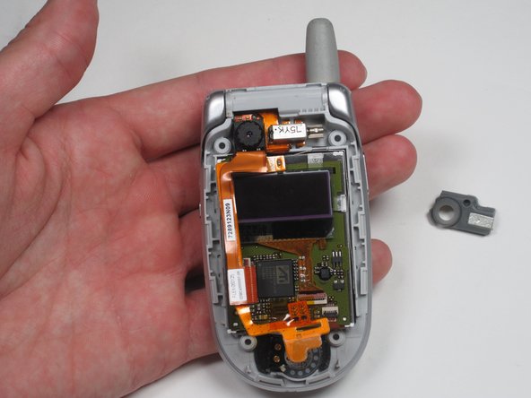

    6. Motorola V557 Camera Replacement: crwdns2935265:012crwdnd2935265:01crwdnd2935265:02crwdne2935265:0 Motorola V557 Camera Replacement: crwdns2935265:012crwdnd2935265:02crwdnd2935265:02crwdne2935265:0
      • Lift the top ribbon cable, with camera attached, up and away from the rest of the phone.
