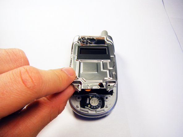

    • Loosen and remove the protective cover using a plastic opening tool.
  4. Motorola V551 Earpiece Speaker Replacement: crwdns2935265:04crwdnd2935265:01crwdnd2935265:02crwdne2935265:0 Motorola V551 Earpiece Speaker Replacement: crwdns2935265:04crwdnd2935265:02crwdnd2935265:02crwdne2935265:0

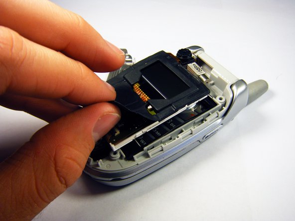

    • Gently loosen the second protective cover with the plastic opening tool.
  5. Motorola V551 Earpiece Speaker Replacement: crwdns2935265:05crwdnd2935265:01crwdnd2935265:03crwdne2935265:0 Motorola V551 Earpiece Speaker Replacement: crwdns2935265:05crwdnd2935265:02crwdnd2935265:03crwdne2935265:0 Motorola V551 Earpiece Speaker Replacement: crwdns2935265:05crwdnd2935265:03crwdnd2935265:03crwdne2935265:0
    • Carefully remove the protective cover from the circuitry.

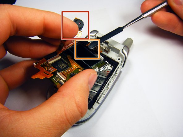

    • Slowly peel the black rubber gasket off of the circuit board.
    • Carefully move the camera out of the way using your hand.
    • Use a flat tool to disconnect the upper and lower circuit boards.
  6. Motorola V551 Earpiece Speaker Replacement: crwdns2935265:06crwdnd2935265:01crwdnd2935265:03crwdne2935265:0 Motorola V551 Earpiece Speaker Replacement: crwdns2935265:06crwdnd2935265:02crwdnd2935265:03crwdne2935265:0 Motorola V551 Earpiece Speaker Replacement: crwdns2935265:06crwdnd2935265:03crwdnd2935265:03crwdne2935265:0
    • Gently slip the copper strip out from under the circuitry by using your hand.

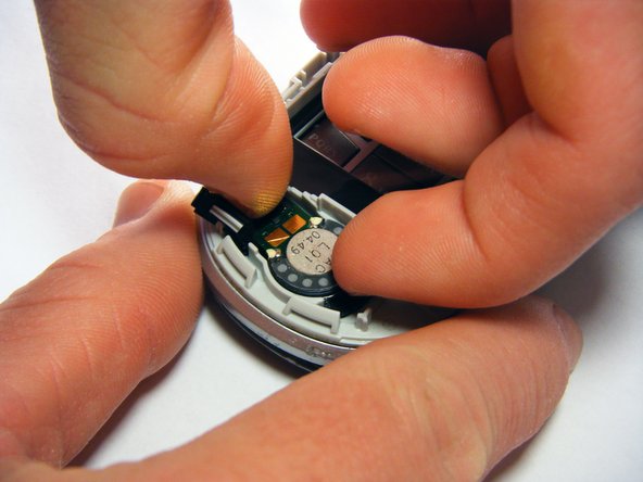

  7. Motorola V551 Earpiece Speaker Replacement, Earpiece Speaker: crwdns2935265:07crwdnd2935265:01crwdnd2935265:03crwdne2935265:0 Motorola V551 Earpiece Speaker Replacement, Earpiece Speaker: crwdns2935265:07crwdnd2935265:02crwdnd2935265:03crwdne2935265:0 Motorola V551 Earpiece Speaker Replacement, Earpiece Speaker: crwdns2935265:07crwdnd2935265:03crwdnd2935265:03crwdne2935265:0
    • Pry out the speaker using your fingers.
