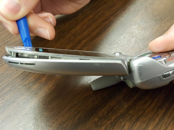

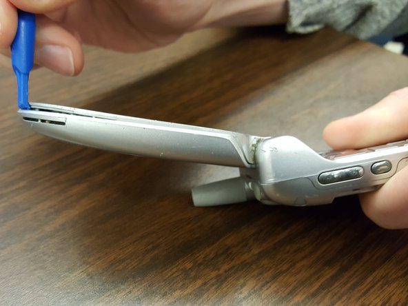

  3. Motorola V400 Camera Replacement: crwdns2935265:03crwdnd2935265:01crwdnd2935265:03crwdne2935265:0 Motorola V400 Camera Replacement: crwdns2935265:03crwdnd2935265:02crwdnd2935265:03crwdne2935265:0 Motorola V400 Camera Replacement: crwdns2935265:03crwdnd2935265:03crwdnd2935265:03crwdne2935265:0
    • Use a plastic opening tool to separate outer shell from metal interior cover by sliding it along the crease in the case.
    • To easily take off the case close the phone before trying to remove it.

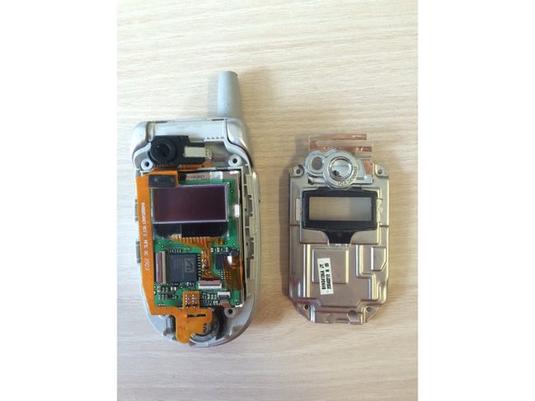

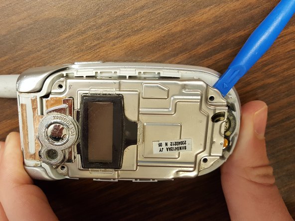

  4. Motorola V400 Camera Replacement: crwdns2935265:04crwdnd2935265:01crwdnd2935265:03crwdne2935265:0 Motorola V400 Camera Replacement: crwdns2935265:04crwdnd2935265:02crwdnd2935265:03crwdne2935265:0 Motorola V400 Camera Replacement: crwdns2935265:04crwdnd2935265:03crwdnd2935265:03crwdne2935265:0
    • Use a plastic opening tool to separate the inner metal cover from the circuit board. Apply pressure to remove the piece.

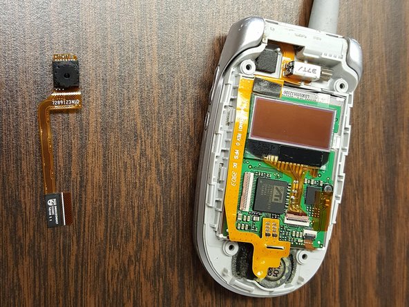

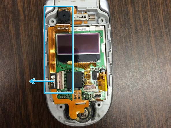

  5. Motorola V400 Camera Replacement: crwdns2935265:05crwdnd2935265:01crwdnd2935265:03crwdne2935265:0 Motorola V400 Camera Replacement: crwdns2935265:05crwdnd2935265:02crwdnd2935265:03crwdne2935265:0 Motorola V400 Camera Replacement: crwdns2935265:05crwdnd2935265:03crwdnd2935265:03crwdne2935265:0
    • Remove rubber covering over the camera.
    • Carefully remove camera and the attached orange ribbon by gently pulling on it. Pull out in the direction of the blue arrow. You can use your fingers or tweezers.
