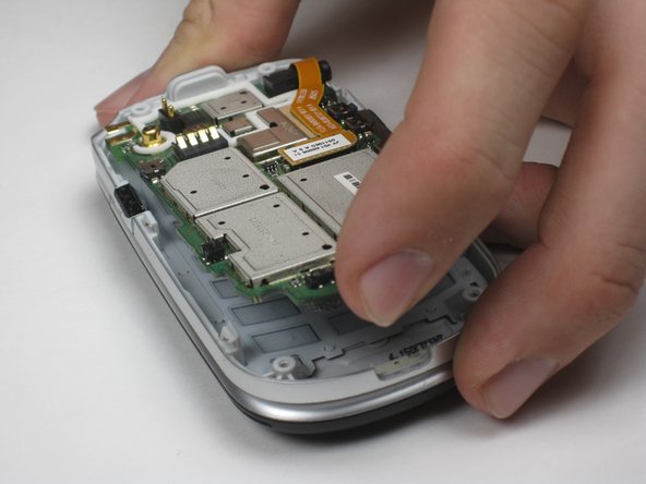

  9. Motorola V325 Keypad Replacement, Keypad: crwdns2935265:09crwdnd2935265:01crwdnd2935265:01crwdne2935265:0
    • Make sure the phone appears as shown after removing the rear panel.

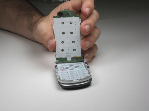

  10. Motorola V325 Keypad Replacement: crwdns2935265:010crwdnd2935265:01crwdnd2935265:03crwdne2935265:0 Motorola V325 Keypad Replacement: crwdns2935265:010crwdnd2935265:02crwdnd2935265:03crwdne2935265:0 Motorola V325 Keypad Replacement: crwdns2935265:010crwdnd2935265:03crwdnd2935265:03crwdne2935265:0
    • Gently lift up the logic board by placing your index finger at the top while keeping your thumb at the bottom of the phone for leverage.

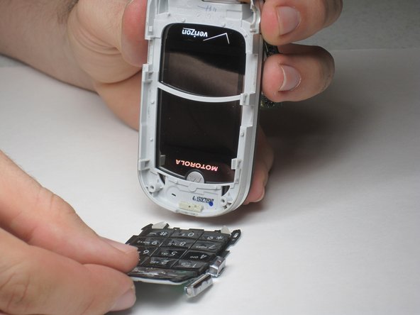

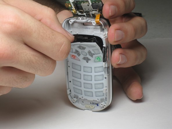

  11. Motorola V325 Keypad Replacement: crwdns2935265:011crwdnd2935265:01crwdnd2935265:03crwdne2935265:0 Motorola V325 Keypad Replacement: crwdns2935265:011crwdnd2935265:02crwdnd2935265:03crwdne2935265:0 Motorola V325 Keypad Replacement: crwdns2935265:011crwdnd2935265:03crwdnd2935265:03crwdne2935265:0
    • Gently remove the keypad from the phone by getting a grip on the top of the keypad and slowly peeling it top to bottom.
