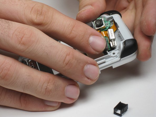

  7. Motorola V325 Camera Replacement, Camera: crwdns2935265:07crwdnd2935265:01crwdnd2935265:02crwdne2935265:0 Motorola V325 Camera Replacement, Camera: crwdns2935265:07crwdnd2935265:02crwdnd2935265:02crwdne2935265:0
    • Remove the cover on the vibrator by simply pulling it off gently.

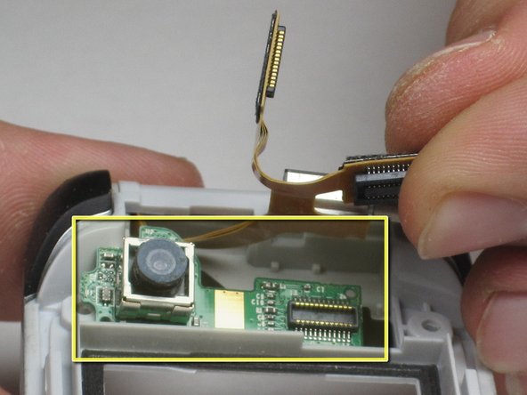

  8. Motorola V325 Camera Replacement: crwdns2935265:08crwdnd2935265:01crwdnd2935265:01crwdne2935265:0
    • Pull out the small circuit board where the camera is mounted.
    • Be careful with the yellow ribbon attaching both sides of the phone. It can break if pulled on too hard.

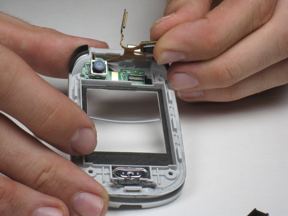

  9. Motorola V325 Camera Replacement: crwdns2935265:09crwdnd2935265:01crwdnd2935265:03crwdne2935265:0 Motorola V325 Camera Replacement: crwdns2935265:09crwdnd2935265:02crwdnd2935265:03crwdne2935265:0 Motorola V325 Camera Replacement: crwdns2935265:09crwdnd2935265:03crwdnd2935265:03crwdne2935265:0
    • Detach the clip from the camera's circuit board carefully by pulling them apart with your fingers.
    • The camera should now be completely detached as shown here in yellow.
  10. Motorola V325 Camera Replacement: crwdns2935265:010crwdnd2935265:01crwdnd2935265:01crwdne2935265:0
    • This is the piece that is removed from the phone.
    • You will need to replace this entire piece for the camera to function properly again.
