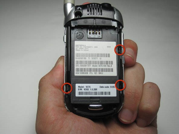

  5. Motorola V276 Headphone Jack Replacement: crwdns2935265:05crwdnd2935265:01crwdnd2935265:01crwdne2935265:0
    • Using a Hex T6 screwdriver, remove the 4 screws holding the back plate of the phone in place

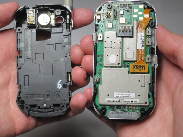

  6. Motorola V276 Headphone Jack Replacement: crwdns2935265:06crwdnd2935265:01crwdnd2935265:03crwdne2935265:0 Motorola V276 Headphone Jack Replacement: crwdns2935265:06crwdnd2935265:02crwdnd2935265:03crwdne2935265:0 Motorola V276 Headphone Jack Replacement: crwdns2935265:06crwdnd2935265:03crwdnd2935265:03crwdne2935265:0
    • Using your hands, pull up on the back plate while pulling on the 3 side tabs to remove the back plate.
    • Be careful when removing the back plate; don't put too much stress on the back plate or the plastic may snap
  7. Motorola V276 Headphone Jack Replacement: crwdns2935265:07crwdnd2935265:01crwdnd2935265:01crwdne2935265:0
    • On the back casing, using a spudger, push into the headphone jack at an upward angle to pop it out
