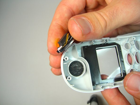

  6. Motorola V2397 Speakers Replacement, Speaker: crwdns2935265:06crwdnd2935265:01crwdnd2935265:02crwdne2935265:0 Motorola V2397 Speakers Replacement, Speaker: crwdns2935265:06crwdnd2935265:02crwdnd2935265:02crwdne2935265:0
    • Use the iFixit opening tool to lift the speaker off the front cover.
