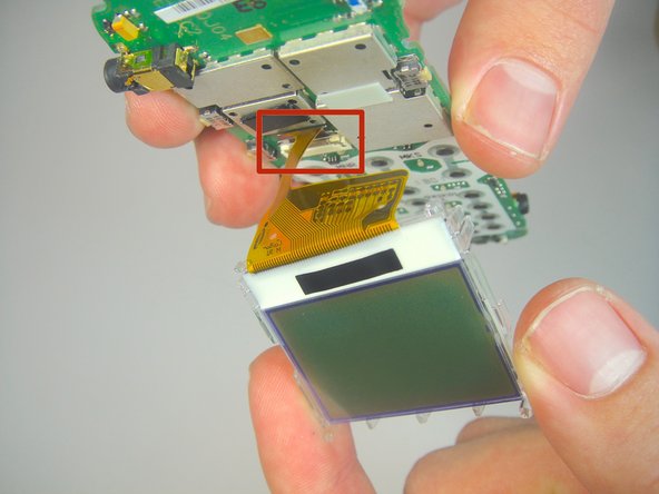

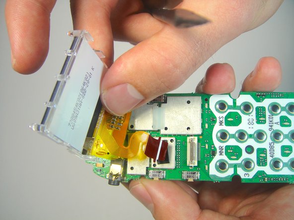

  6. Motorola V2397 Motherboard/Screen Replacement, Motherboard/Screen: crwdns2935265:06crwdnd2935265:01crwdnd2935265:02crwdne2935265:0 Motorola V2397 Motherboard/Screen Replacement, Motherboard/Screen: crwdns2935265:06crwdnd2935265:02crwdnd2935265:02crwdne2935265:0
    • Use your fingers to unhook the highlighted plastic frame of the screen from motherboard
    • Carefully separate the screen from the motherboard
    • Note the cable connecting the screen to the motherboard. Do not pull the screen too far from the motherboard or you may damage the cable
  7. Motorola V2397 Motherboard/Screen Replacement: crwdns2935265:07crwdnd2935265:01crwdnd2935265:02crwdne2935265:0 Motorola V2397 Motherboard/Screen Replacement: crwdns2935265:07crwdnd2935265:02crwdnd2935265:02crwdne2935265:0
    • Lift the flap of the connector on the motherboard using a spudger
    • Carefully remove the FFC cable from the connector
    • The screen should now be free from the motherboard
