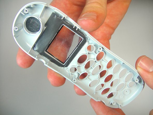

  9. Motorola V2397 Front Cover Replacement, Front Cover: crwdns2935265:09crwdnd2935265:01crwdnd2935265:02crwdne2935265:0 Motorola V2397 Front Cover Replacement, Front Cover: crwdns2935265:09crwdnd2935265:02crwdnd2935265:02crwdne2935265:0
    • Once the motherboard, speaker, and keypad have been removed you should have the front cover by itself
