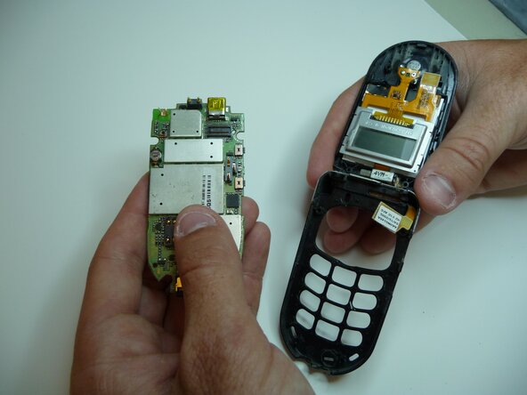

    1. Motorola V180 Motherboard Replacement, Motherboard: crwdns2935265:02crwdnd2935265:01crwdnd2935265:03crwdne2935265:0 Motorola V180 Motherboard Replacement, Motherboard: crwdns2935265:02crwdnd2935265:02crwdnd2935265:03crwdne2935265:0 Motorola V180 Motherboard Replacement, Motherboard: crwdns2935265:02crwdnd2935265:03crwdnd2935265:03crwdne2935265:0
      • Use your T6 Torx Screwdriver to unscrew the four screws located on the back of the phone.
      • Remove the SIM card located on the back of the phone.
      • A ribbon near the antenna is still attached to the motherboard. Do not break this ribbon.
    2. Motorola V180 Motherboard Replacement: crwdns2935265:03crwdnd2935265:01crwdnd2935265:02crwdne2935265:0 Motorola V180 Motherboard Replacement: crwdns2935265:03crwdnd2935265:02crwdnd2935265:02crwdne2935265:0
      • Unclip the pronged rectangle connector ribbon attached to the motherboard.
      • Remove the motherboard by lifting it up out of the keypad.
