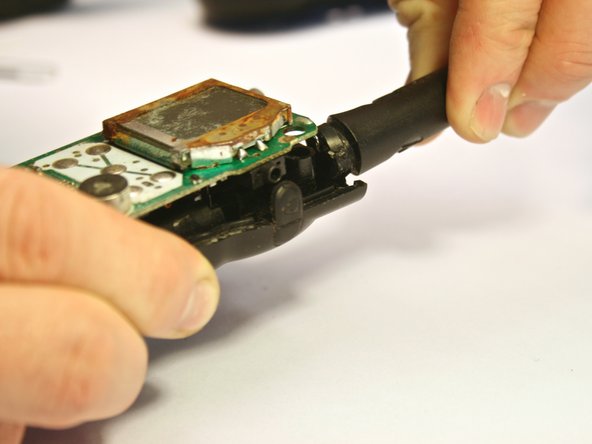

    • Gently open the backplate of the radio. Use a flathead screwdriver to slowly pry apart the two sides.
    • Be careful, as the antenna is still attached. Pulling the two sides apart too quickly could break the antenna.

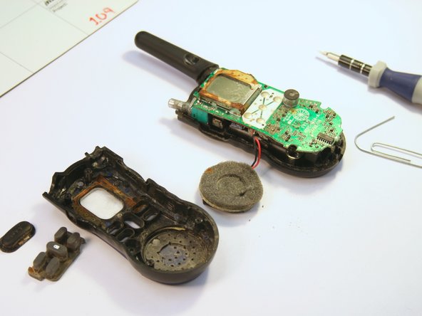

    • Gently pull the circuit board away from the front faceplate.
    • Be careful not to tug the wire connecting the circuit board to the speaker, as it is still attached to the faceplate.
    • Do not touch the the button contacts on the circuit board (the button contacts are shown in the red box of the second picture). This can cause long-term damage to the radio unless you properly clean them (see Repairing Motorola TALKABOUT FV700 Two Way Radio Button Contacts Guide).

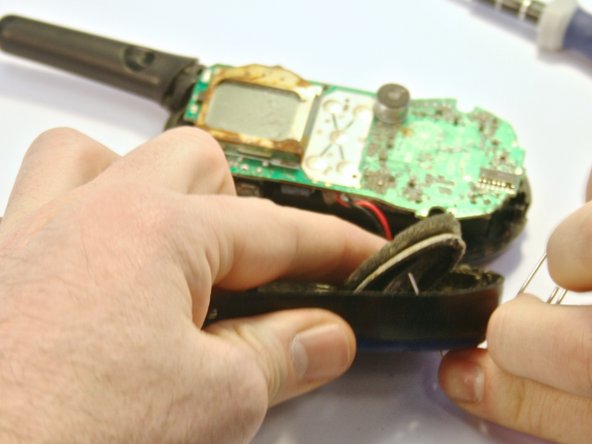

    • To remove the speaker from the faceplate, insert a paperclip through the front faceplate and push.
    • The speaker is glued to the front faceplate, so it may take some force to remove the speaker.

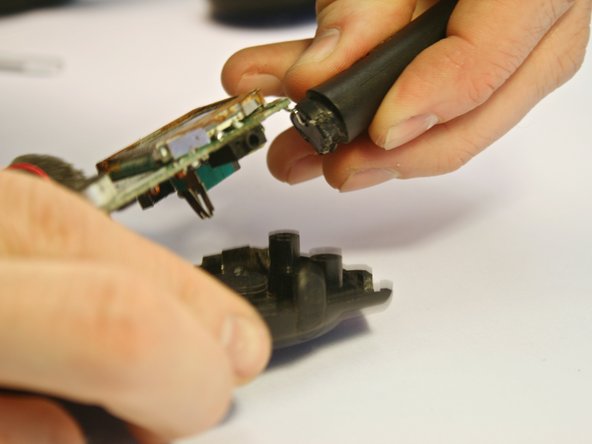

    • Now the circuit board can be removed from the back faceplate.
    • To do this, grip the back faceplate in one hand and the antenna in the other. Pull and twist the antenna away from the back faceplate. The circuit board should be removed with the antenna, as they are attached.
