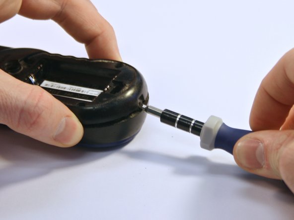

  5. Motorola Talkabout FV700R Circuit Board Replacement, Front Faceplate: crwdns2935265:05crwdnd2935265:01crwdnd2935265:01crwdne2935265:0
    • Remove the four 3 millimeter T6 Torx screws from the front of the radio.
  6. Motorola Talkabout FV700R Circuit Board Replacement: crwdns2935265:06crwdnd2935265:01crwdnd2935265:02crwdne2935265:0 Motorola Talkabout FV700R Circuit Board Replacement: crwdns2935265:06crwdnd2935265:02crwdnd2935265:02crwdne2935265:0
    • Remove the four 3 millimeter T8 Torx screws from the back of the radio.

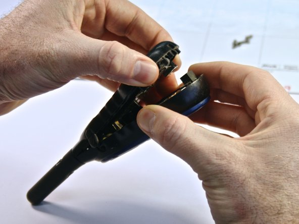

    • Gently open the backplate of the radio. Use a flathead screwdriver to slowly pry apart the two sides.
    • Be careful, as the antenna is still attached. Pulling the two sides apart too quickly could break the antenna.

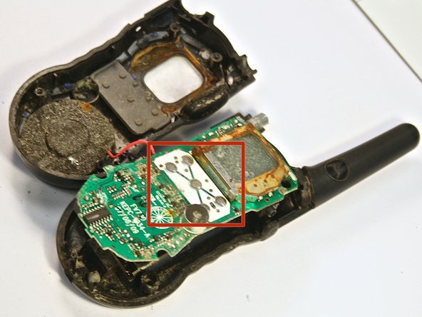

  8. Motorola Talkabout FV700R Circuit Board Replacement: crwdns2935265:08crwdnd2935265:01crwdnd2935265:02crwdne2935265:0 Motorola Talkabout FV700R Circuit Board Replacement: crwdns2935265:08crwdnd2935265:02crwdnd2935265:02crwdne2935265:0
    • Gently pull the circuit board away from the front faceplate.
    • Be careful not to tug the wire connecting the circuit board to the speaker, as it is still attached to the faceplate.
    • Do not touch the the button contacts on the circuit board (the button contacts are shown in the red box of the second picture). This can cause long-term damage to the radio unless you properly clean them (see Repairing Motorola TALKABOUT FV700 Two Way Radio Button Contacts Guide).

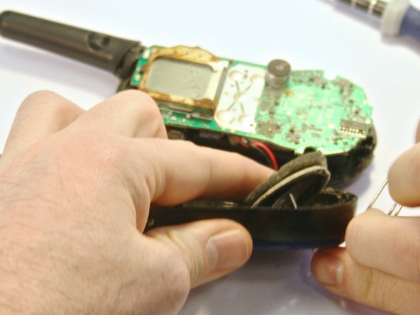

  9. Motorola Talkabout FV700R Circuit Board Replacement, Circuit Board: crwdns2935265:09crwdnd2935265:01crwdnd2935265:03crwdne2935265:0 Motorola Talkabout FV700R Circuit Board Replacement, Circuit Board: crwdns2935265:09crwdnd2935265:02crwdnd2935265:03crwdne2935265:0 Motorola Talkabout FV700R Circuit Board Replacement, Circuit Board: crwdns2935265:09crwdnd2935265:03crwdnd2935265:03crwdne2935265:0
    • To remove the speaker from the faceplate, insert a paperclip through the front faceplate and push.
    • The speaker is glued to the front faceplate, so it may take some force to remove the speaker.

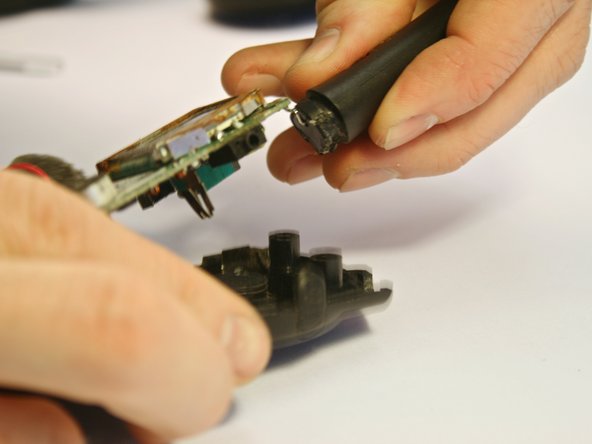

  10. Motorola Talkabout FV700R Circuit Board Replacement: crwdns2935265:010crwdnd2935265:01crwdnd2935265:03crwdne2935265:0 Motorola Talkabout FV700R Circuit Board Replacement: crwdns2935265:010crwdnd2935265:02crwdnd2935265:03crwdne2935265:0 Motorola Talkabout FV700R Circuit Board Replacement: crwdns2935265:010crwdnd2935265:03crwdnd2935265:03crwdne2935265:0
    • Now the circuit board can be removed from the back faceplate.
    • To do this, grip the back faceplate in one hand and the antenna in the other. Pull and twist the antenna away from the back faceplate. The circuit board should be removed with the antenna, as they are attached.

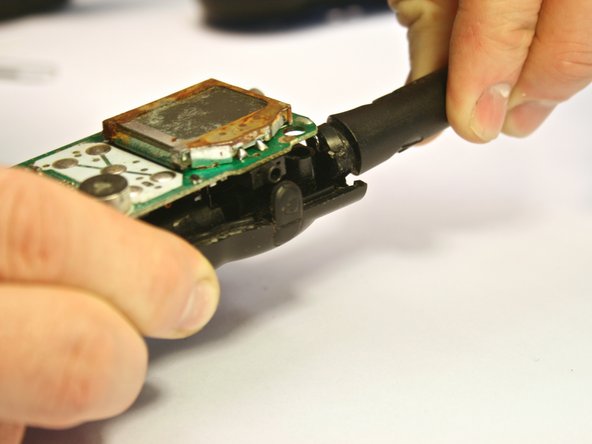

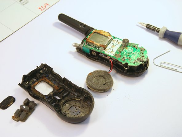

  11. Motorola Talkabout FV700R Circuit Board Replacement: crwdns2935265:011crwdnd2935265:01crwdnd2935265:01crwdne2935265:0
    • After pulling the circuit board away from the backplate, the result should be as shown in the picture.

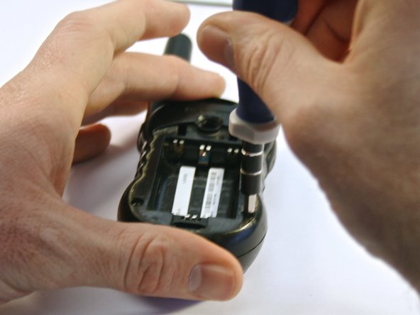

  12. Motorola Talkabout FV700R Circuit Board Replacement: crwdns2935265:012crwdnd2935265:01crwdnd2935265:01crwdne2935265:0
    • Remove all wires from the circuit board with a soldering iron.
    • Be careful when using the soldering iron.
    • Properly dispose of the old circuit board and solder the speaker onto the new circuit board.
